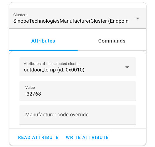

I did not install the quirks yet, I tried the outdoor temp blueprint and used entity names (I selected them from the drop down menu) and my thermostat still don’t show the outdoor temp. Do I need to enable something else?

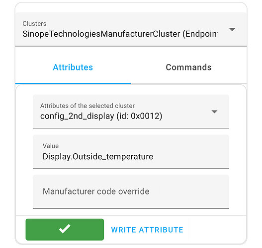

For the outside temperature you need to set attr config_2nd_display 0x0012 to value 2. You can do it in the manage zigbee device you already used.
Then you can use this automation if you are with regular ZHA.
- id: Heat-OutdoorTemp
  alias: Heat-OutdoorTemp
  triggers:
    - trigger: state
      entity_id: sensor.varennes_local
  variables:
    thermostats:
      - 50:0b:91:40:00:02:26:6d
      - f0:82:c0:ff:fe:62:bd:72
  actions:
    - repeat:
        count: "{{thermostats|length}}"
        sequence:
          - action: zha.set_zigbee_cluster_attribute
              ieee: "{{ thermostats[repeat.index-1] }}"
              endpoint_id: 1
              cluster_id: 0xff01
              cluster_type: in
              attribute: 0x0010
              value: "{{ ( trigger.to_state.state|float * 100 ) |int }}"
  mode: single
in thermostat you put all your thermostat ieee, one per line.
You can put in configuration.yaml:
automation mine: !include_dir_merge_list automation/
then create a directory in config, automation
in automation create a file for example, auto_update.yaml and paste the automation code above.
After just reload the automation in HA
I cannot set the value to « 2 » ?
