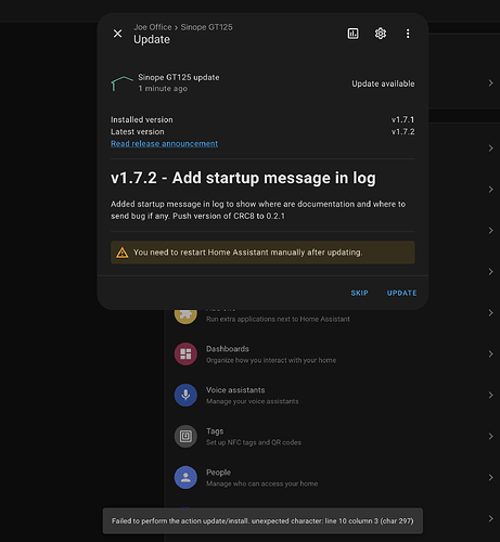

The GT125 update failed to install today… due to this error.
Look st the bottom for the error…
Thanks for reporting this. Look like the zip file is corrupted. I’ll check.
The bug seams to be in hacs. You still can download manually the zip file at Releases · claudegel/sinope-gt125 · GitHub
Pick the source code (zip). unpack the zip somewhere. it will create a dir named sinope-gt125-1.7.2 inside you will see dir custom_components and in it sinope. In sinope copy all 10 files into your config/custom_components/sinope dir and restart HA.
On my side I’ll try to find out what is the problem. The error message is not very helpfull.

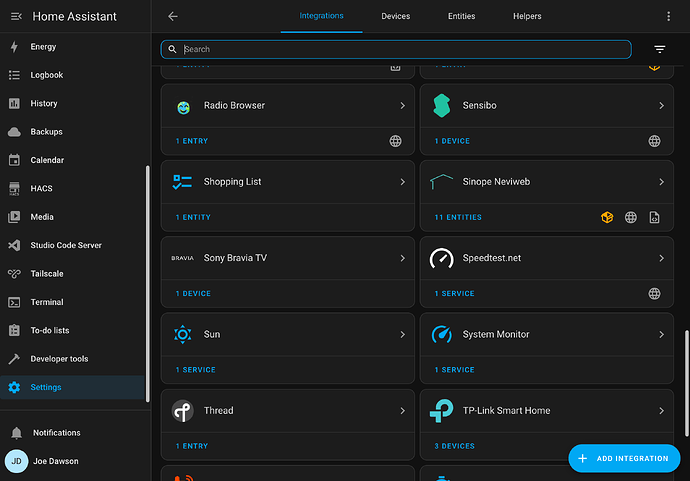

Well that didn’t go well… :frowning:
The GT125 service never loaded…
I did make a copy of what was in the folder before I replaced the ten files and put them back and everything worked again.
But the new version just didn’t load replacing that folder.
Ok I’ve found the bug. It’s in the manifest.json file. I’ll fix it today and make a new version. I’ve added some property in that file to comply with HA new requirements but forgot a coma at the end of the line 9 and 10. Too hot outside… burn my brain :grin:
I’ just push a new release that fix manifest.json that prevent loading in HA.
Let me know if it is OK
I can confirm this worked and I could use the update in the HA not download the file and manually update.
Thank you for reporting this
So was the bug in the manifest.json the real reason the automatic update didn’t install?
Yes because I forgot to put a comma at the end of the line 9 and 10 and it prevent const.py to load the startup sequence. That sequence read directly from manifest.json. But the line that it need to read was too long, missing comma.
