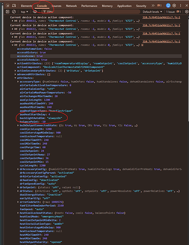

2026-03-30 21:13:11.242 WARNING [custom_components.neviweb130.climate] Running update helper
2026-03-30 21:13:15.176 WARNING [custom_components.neviweb130.climate] Unsupported or ignored attribute detected for device 866613 (SKU: TH6500WF, Model: 6727, Firmware: 4.3.7). Testing attributes individually...
2026-03-30 21:13:16.145 WARNING [custom_components.neviweb130.climate] Attribute 'backlight' ignored or unsupported for device 866613 (SKU: TH6500WF, Model: 6727, Firmware: 4.3.7)
2026-03-30 21:13:19.668 WARNING [custom_components.neviweb130.climate] [Missing translation: error_code]
Weirdly, I do see “Retroeclairage” in the app device params … I am assuming this is the backlight here …
Je parle francais by the way :slight_smile:
Moi ausi :slight_smile:

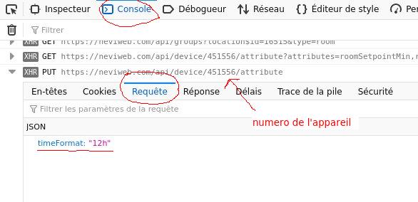

There are two parameters, backlight and backlightAutoDim, Neviweb just ignore backlight but return data for the second one. I’ve sent a notice to Sinopé because there are many devices that have ignored parameters when we do the device update.
In Neviweb app you should see for backlightAutoDim: alwaysOn, auto or bedroom as parameter values. So if you get the same values for Retroeclairage it is in fact backlightAutoDim parameter.
You can validate in Neviweb when you open de device configuration, hitting F12 will open the browser dev console and in it you will see what Neviweb is sending back (numéro de l’appareil is different from yours)
Check in Réponse instead of Requête you will see all parameters send back by neviweb when you open the device configuration page.
If you get something for backlight then it is a bug from Sinopé. Send me what you get.

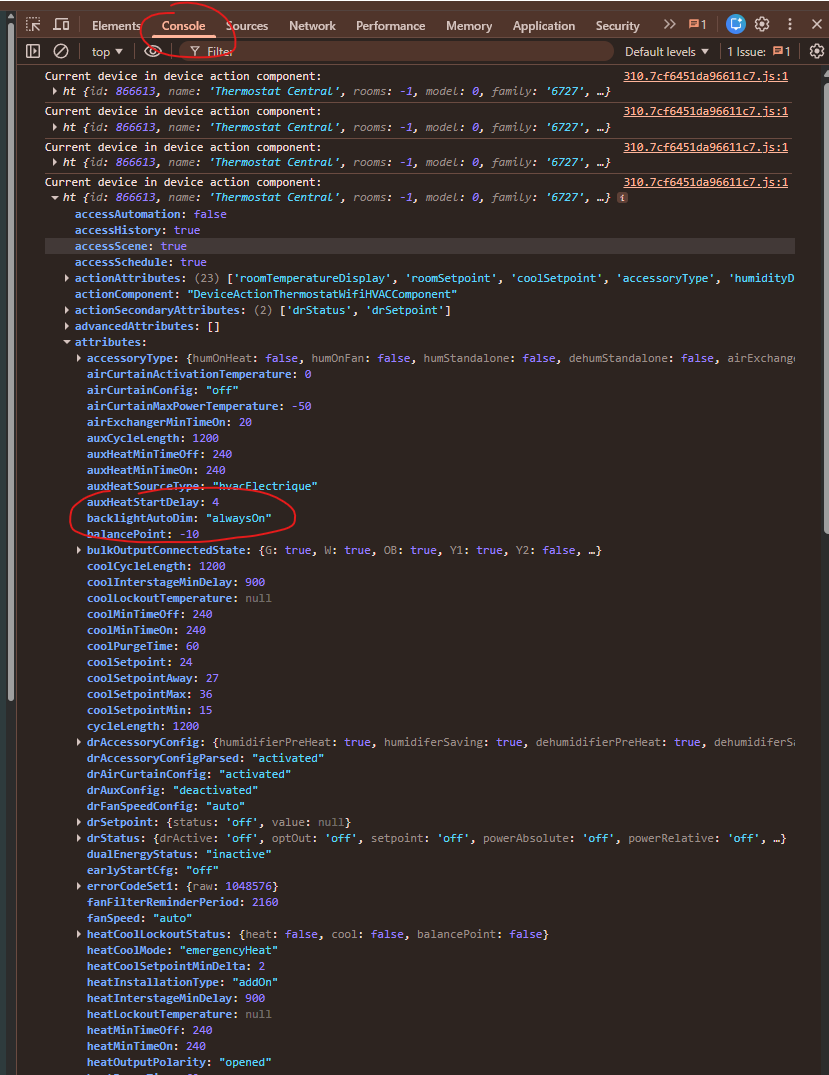

I was able to F12 and get to the Console tab but couldn’t find that second bottom window … I’m using Chrome though…
Not sure if that will help ?
As for the backlightAutoDim, values are : alwaysOn, onUserAction and bedroom
Yes this is ok. Chrome have a dev console on the right of the screen and firefox put the console at the bottom. But you get to the rite place. You have backLightAutoDim but no backLight attribute. Neviweb just ignore it and it was causing a bug.

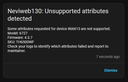

Hi Claude
Just updated to your newly release and now I have this :
Hope this helps!
Yes this is normal. In previous version you had an error about Error code not found. Now I’ve fixed the translation that set a default message if an error occur before the HA translation engine is loaded at startup.
The external sensor disconnected is because Sinopé added the possibility to connect a temperature sensor to your TH6500WF in your firmware but didn’t provide the sensor and didn’t set in Neviweb the possibility to tell that you don’t have the sensor.
You’ll get this error once at each reboot until Sinopé wake up and fix it.
