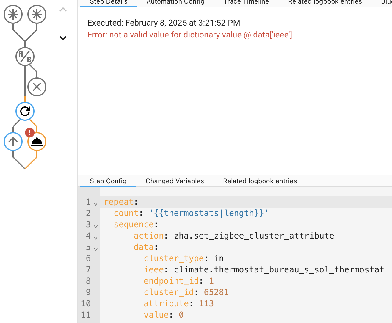

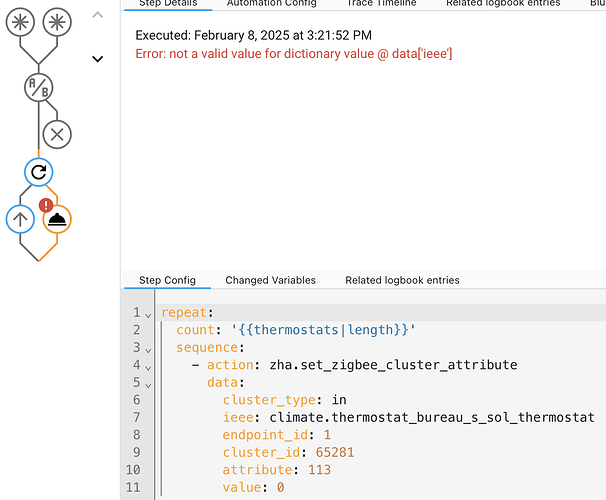

Doesn’t seems to be the case. I’ve copied the blueprint and replace ieee: ‘{{ thermostats[repeat.index-1] }}’ by the climate device and I get an error.
However, if I put the ieee address, it work. I tried adding single quote and double quote and it change nothing. Did I missed something? Yes I made sure the name is correctly spelled as you can see in the current entity states screenshot below.

No you should put the climate.thermostat_bureau_s_thermostat like this:
variables:
  thermostats:
    - climate.thermostat_bureau_s_thermostat
    - climate.thermostat_bureau_s_thermostat2
Don’t touch the line ieee:
You can add many device that will be activated for the DR logo
