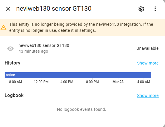

I have this error average 30 minutes after upgrade to 2.9.9.
Logger: homeassistant.helpers.entity
Source: helpers/entity.py:960
First occurred: 10:39:26 AM (1 occurrences)
Last logged: 10:39:26 AM
Update for sensor.neviweb130_sensor_gt130 fails
File “/usr/src/homeassistant/homeassistant/helpers/entity.py”, line 960, in async_update_ha_state
await self.async_device_update()
File “/usr/src/homeassistant/homeassistant/helpers/entity.py”, line 1320, in async_device_update
await hass.async_add_executor_job(self.update)
File “/usr/local/lib/python3.13/concurrent/futures/thread.py”, line 59, in run
File “/config/custom_components/neviweb130/sensor.py”, line 1048, in update
self._occupancyMode = neviweb_status[ATTR_OCCUPANCY]
KeyError: ‘occupancyMode’
I restarted HA and the error no longer appears.
