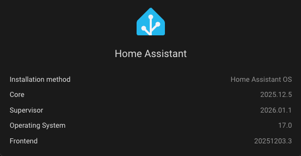

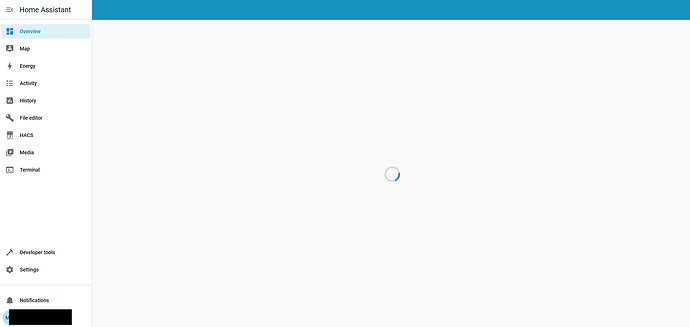

I seem to have narrowed it down to something in HA Core between 2025.12.5 and 2026.1.0. I had a backup of a 2025.12.5 version (where the dashboard loads just fine). I also tried to restore from a 2026.1.0 version where the dashboard does not load and just spins.
I know the 2026.1 version had some dashboard changes. Not sure if that had something to do with this or not.
See screenshots of version info below…
Version info where the dashboard DOES load:
Version info where the dashboard DOES NOT load:
