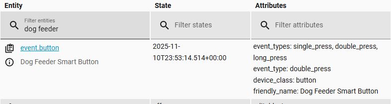

Look in Developer Tools → States. Do you see an event entity for your mini switch that has a state value of the last time it was pressed, or is it an action entity?
Thanks Tom for the quick response!

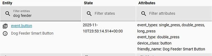

I have taken snapshot of the states of the mini switch.
I am not sure what to do from here.

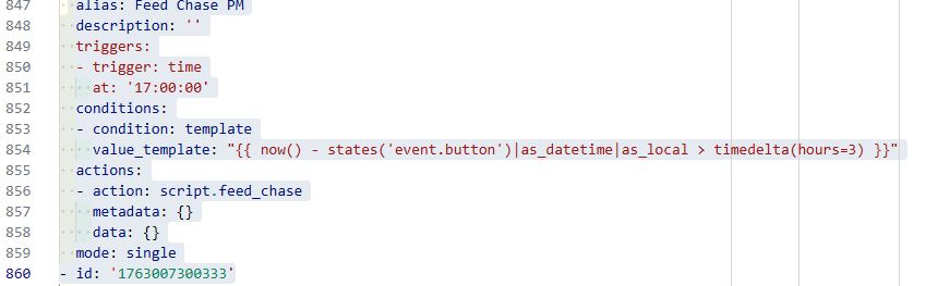

Just so I am understanding correctly, I went into the automations.yaml and pasted what you had provided. Here is a how it looks.
Tom,
Thanks again. My automation appears to be working flawlessly. Thanks Again!
