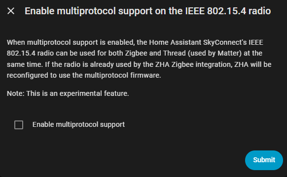

When I go to the configuration page, the only option I have is to enable Multiprotocol

There is only one device listed in the configuration and this is selected.
