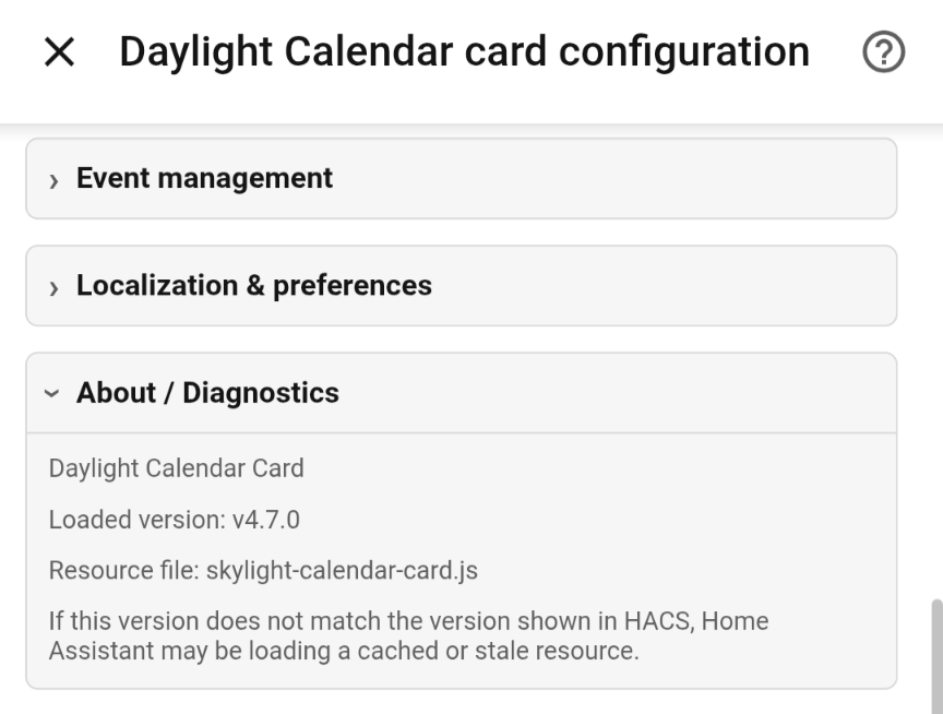

Were you using this card before the rename from Skylight Calendar Card?
Are you keeping up with the latest versions, but new features don't seem to be working or present?
Please check Settings → Dashboards → Resources and remove any old Skylight resource:
:cross_mark: /hacsfiles/skylight-calendar-card/skylight-calendar-card.js
Keep only the current Daylight resource:
:white_check_mark: /hacsfiles/daylight-calendar-card/skylight-calendar-card.js
The filename is still skylight-calendar-card.js; the folder should be daylight-calendar-card.
You can also verify you have the right version loaded by checking the About / Diagnostics section of the card editor. Don't have an About / Diagnostics section at all? This post is targeted to you!
Stale resources can make new features appear missing or broken even when HACS shows the latest version. See the troubleshooting guide:
I missed the new renamed version until now.
I did the upgrade, but it does not work anymore. On analysis I noticed that the new version still get installed under the folder skylight-calendar-card. Even after I deleted the installation and readded it.
EDIT:
deinstall - restart HA - install - restart HA solved that problem.
On Chrome STRG-F5 or Shift-STRG-R did not work. Need to delete website data fro, chrome settings
Thank you for this information. I am dismayed that so many individuals are likely, unknowingly, "stuck" on the old file. There are so many new features implemented since then!
Thanks, I will review my troubleshooting docs with your feedback and update them to reflect what you had to do.

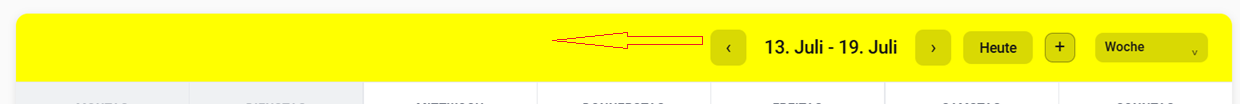

Hi, some Question, is it possible to center the header buttons?
actual code
title: ""
entities:
  - calendar.arbeit
  - calendar.familie
  - calendar.geburtstage_2
  - calendar.juna
  - calendar.nur_jara
  - calendar.nur_jenni
  - calendar.nur_torben
  - calendar.privat
  - calendar.srh_abfuhren
default_view: week-compact
first_day_of_week: 1
week_days:
  - 0
  - 1
  - 2
  - 3
  - 4
  - 5
  - 6
week_start_hour: 0
week_end_hour: 23
lock_schedule_hours: false
hide_the_past: false
past_event_mode: none
disable_swipe_controls: false
show_all_events_month: false
show_all_details_month: false
month_day_tap_action: create
hide_empty_days: false
agenda_compact_events: false
shorten_event_times: false
time_zone: Germany/Berlin
display_full_weekday_names: true
compact_width: true
show_current_time_bar: false
show_event_location: false
use_short_location: false
location_links: false
event_location_font_size: 9
background_opacity: 0
header_background_opacity: 0
event_calendar_friendly_name: true
event_title_prefix: friendly_name
combine_style: bars
combine_background: primary
event_color_mode: classic
event_neutral_background: "#F8F3E9"
event_tint_opacity: 80
event_color_bar_width: 18
day_badges: []
day_badge_layout_week: inline
hide_calendars: true
hide_header: false
hide_year: true
hide_controls: false
hide_navigation_buttons: false
hide_add_event_button: false
hide_view_selector: false
hide_dark_mode_toggle: true
show_dashboard_nav_button: false
header_dashboard_path: null
header_weather_sensor: ""
calendar_person_entities: {}
default_hidden_calendars: []
color_scheme: light
enable_event_management: true
event_modal_size: medium
type: custom:daylight-calendar-card
grid_options:
  columns: 36
  rows: auto
show_week_numbers_month: false
hide_calendar_names: false
compact_header: true
compact_height: false
header_color: "#ffff00"
background_transparent: false
header_background_transparent: false
calendar_names:
  calendar.juna: Juna
  calendar.nur_jara: Jara
  calendar.nur_jenni: Jenni
  calendar.nur_torben: Torben
  calendar.srh_abfuhren: Müll
  calendar.familie: Familie
  calendar.geburtstage: Geburtstag
colors:
  calendar.nur_torben: "#000000"
  calendar.juna: "#E44B8D"
language: de
rolling_days_week_compact: null
header_text_color: "0000000"
height_scale: 0.5
day_styles:
  - condition: past
    style:
      opacity: 0.4
Yes. Since you have an empty title and are using the compact header, you can center the controls with a UIX override:
uix:
  style: |
    .header-compact {
      justify-content: center !important;
    .header-compact > .compact-header-left {
      display: none !important;
    .header-compact > .compact-header-controls {
    .header-compact .compact-period-controls {
      margin-left: 0 !important;
Add this directly to your Daylight Calendar Card configuration. It only affects that specific card instance.
For more info: uix: Inject Custom CSS into Daylight Calendar Card - Daylight Calendar Card

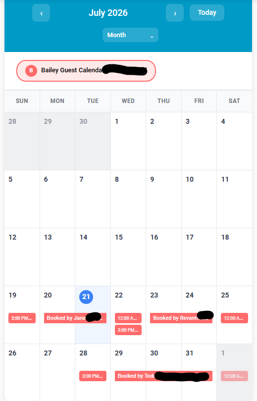

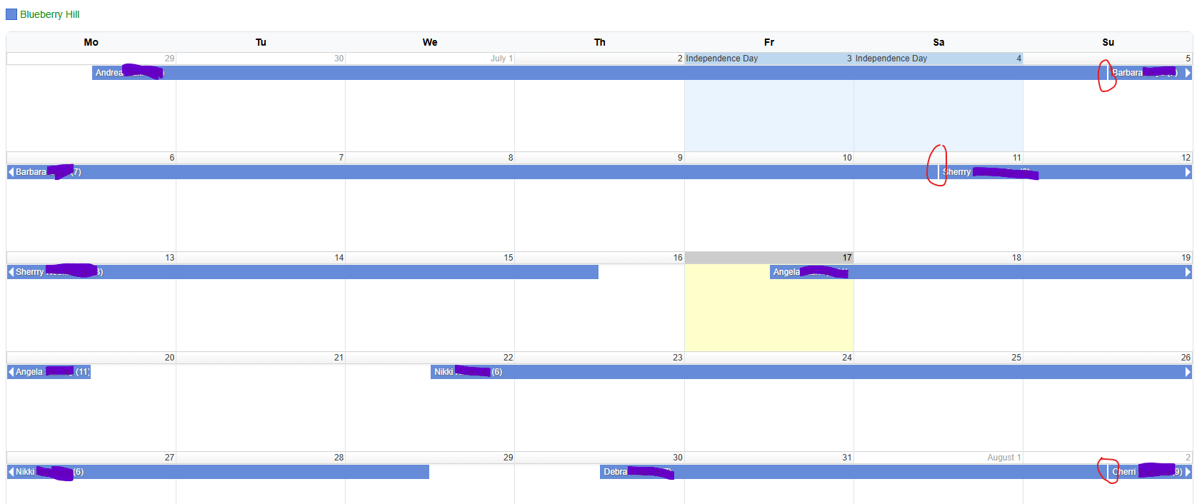

Any chance of tweaking this to display multi-day events like this? The key here is illustrating same-day Airbnb checkins & checkouts.
Here is what yours looks like:
Here’s what I’m trying to accomplish. Note the visual gaps between same-day turnovers, circled in red

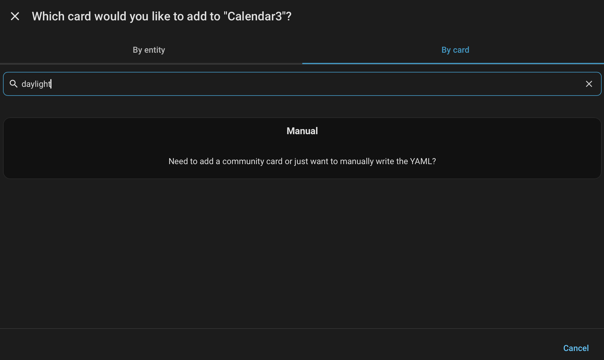

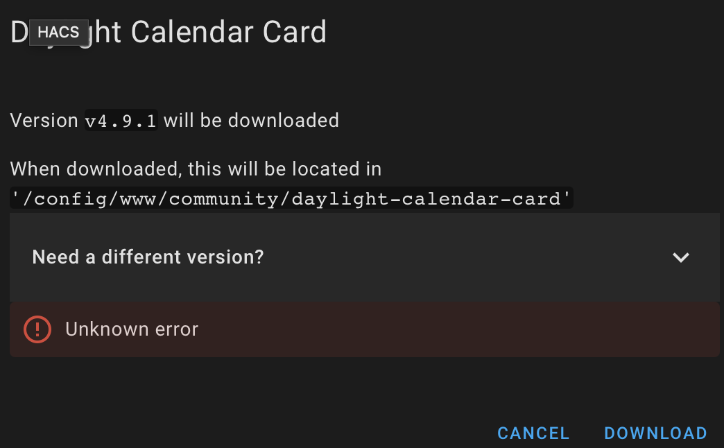

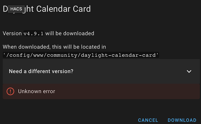

When trying to download it, it says “Unknown error”.
I’ve updated HACS, the download now seems to work but I still can’t find the card in cards section.
I also replied to your issue on GitHub, but please try:
  1. Clear your browser cache, or try it in incognito mode.
  2. Verify the dashboard resource /hacsfiles/daylight-calendar-card/skylight-calendar-card.js
  3. Follow the steps in Daylight Calendar Card: Troubleshooting Common Issues - Daylight Calendar Card
  4. Try to manually download and install the card.
Let me know if you’re still struggling and we can try more things.
