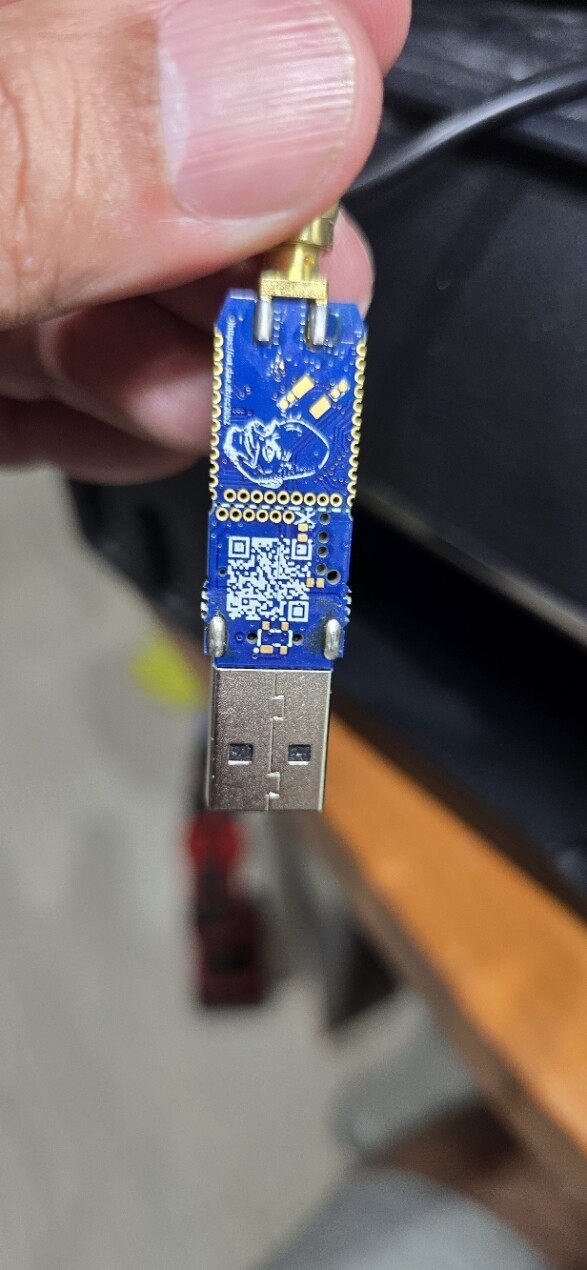

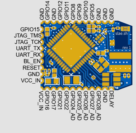

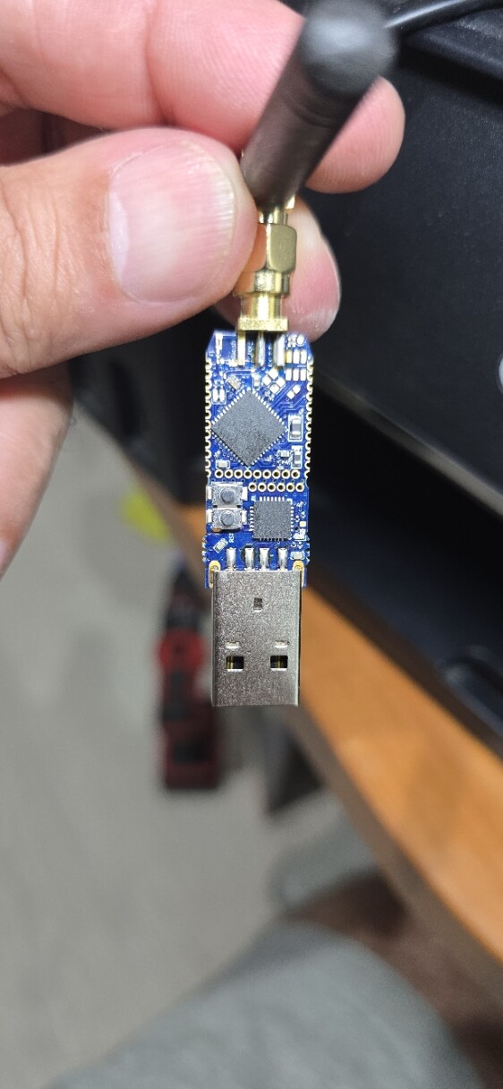

Just to confirm, my USB device is the one in the image. I connected the BL_EN to the GND two pins next to it WHILE inserting it into the USB port. Kept it bridged for 3 seconds and removed the jumper wire, and then tried to flash
Near the USB connector, there’s a pushbutton likely RESET and two pads next to it labeled as GND and BLS or BL_EN these are the critical ones.

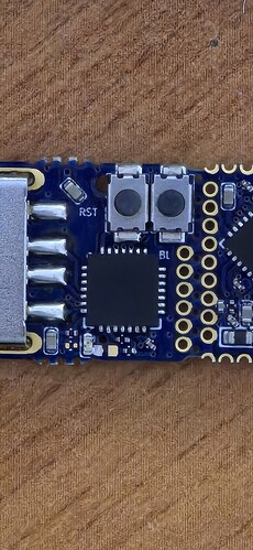

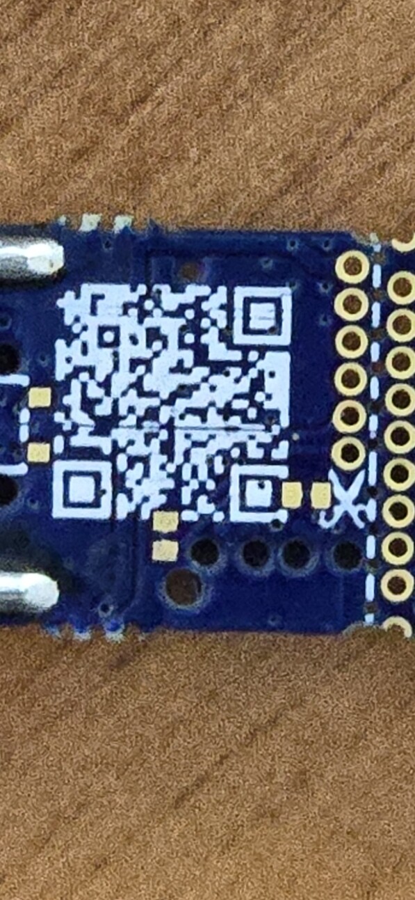

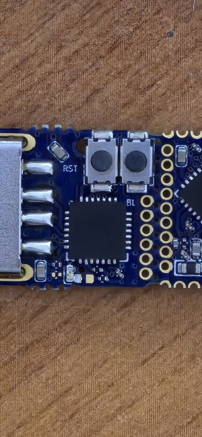

I’m not sure which pad you refer to… Please see attached images, closeups of the two pushbuttons, and the same location but on the backside. There are pads near both the pushbuttons. I dont want to jump the wrong ones… could you please tell me which ones I need to connect together?

i think in yours the BL is the button next to RST ,
try with that one
I tried holding the pushbutton (BL) pressed while connecting to USB, I tried using a jumper wire to connect the two flat pads near the RST (but on the back surface) and also the ones near the BL on the back surface again, and I tried using a jumper wire connecting the BL_EN hole (4th from bottom to top on the image in your answer) and GND (2nd hold from bottom to top)…
Nothing works…
I also tried holding the BL button, while pressing the RST button, then releasing the RST button and after 3 seconds releasing the BL button. Again no game…
