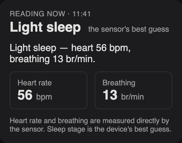

SleepRadar is a small Home Assistant app (HA OS/Supervised) hat brings those sleep readings in as MQTT discovery sensors, and ships with a one-file Lovelace card that shows the live reading.

How accurate is it? Heart rate and breathing are measured by the sensor and have matched reality well for me. The sleep stage (awake/REM/light/deep) is Aqara’s algorithm and is the weakest part; I read about users report being marked awake while asleep. Pair stage triggers with a time window.
What does the card show when nobody’s in bed? A “not measuring” state. The FP2 retains its last in-bed heart-rate and breathing values, and the card hides those instead of presenting them as live. Same when data goes stale: freshness is labeled in the header.

Can it give me a nightly summary or a sleep score? No. The card shows the live reading. The “last night” image in the README is a mockup of what I may add in the future but I didn't want to hold the sensor capabilities back until then. The mockup is labeled as such. The raw sensors plus Recorder let you build your own meanwhile.
