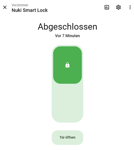

Now i would like to add the Nuki to my dashboard with this STANDARD view from HA.
The Slider etc.
HOW? i really would like to have, this standard, easy view slider - open / close and open door function etc. but i dont get it.

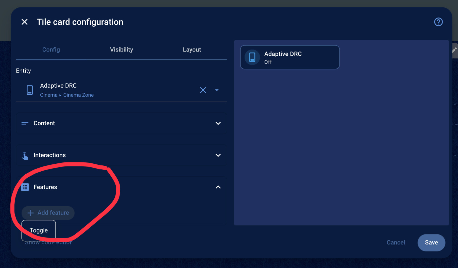

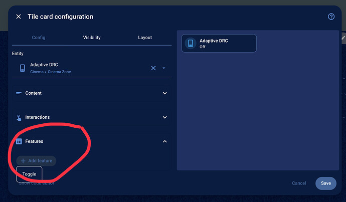

Add a tile card with the toggle feature.
how? when i insert the tile card, i cant select anywhere toggle
also over yaml, when i put in type: toggle this doesnt work :frowning:
for lock, it’s called lock commands
i dont have this “toggle” from your screenshot in the left bottom corner
but is there no way, to get this standard toggle into the dashboard?
i mean, i really dont want to do any extra theme etc. just the standard toggle into the dashboard :smiley:
Did you miss my comment mentioning that it’s not called “toggle” it’s called “Lock commands” for a lock?
i saw it - but this not what i want
look at my first image
i really want to have this toggle switch on my dashboard like my first post
and thats standard UI from HA
and i really dont get it, why this could not be added to a dashboard :frowning:
That’s the more information page, design is not flexible and not available for any dashboard. It’s only available in the more information page.
The main UI only offers small condensed controls.

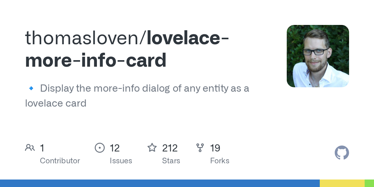

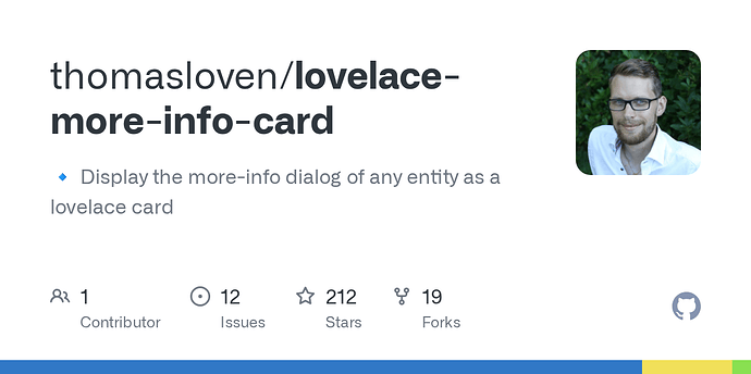

Maybe this is something for you? (I haven’t tested, but it popped up when I searched, maybe you found it too.)
you are my hero!!! THANK YOU LUXIA!!!
thats exactly what i want!! 10000x THANK YOU!!!
