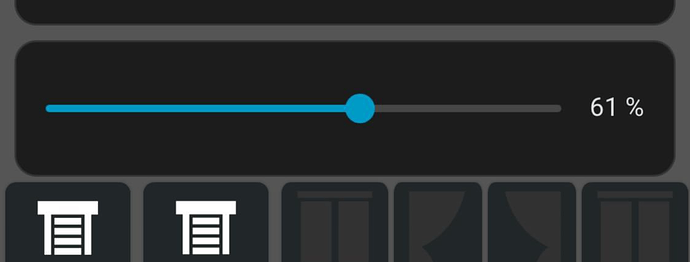

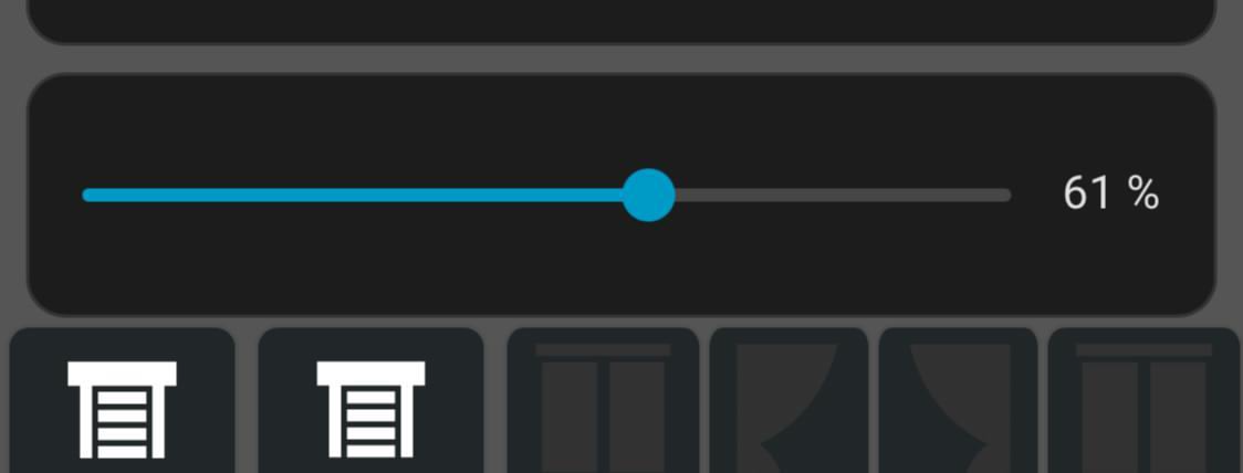

In image 1, this is how I want it. I’ve tried multiple configurations, and in most cases, this is the result. However, occasionally, it appears like image 2. After a refresh (pulling down the screen), it goes back to how it looks in image 1.
^^ image 1 ^^
^^ image 2 ^^

Yes, it works, but sometimes it doesn’t. Then I have to refresh the app because it gets displayed like image 2. (I’ve never seen this happen in the browser on my laptop; it only occurs occasionally in the app.)

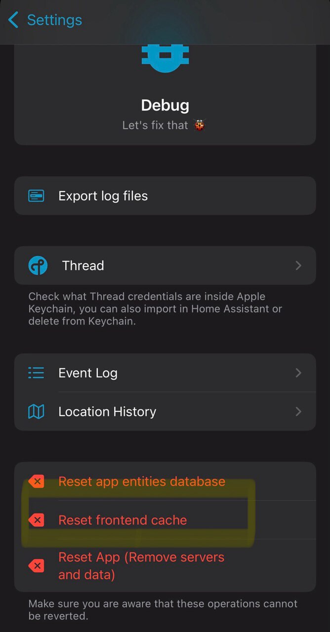

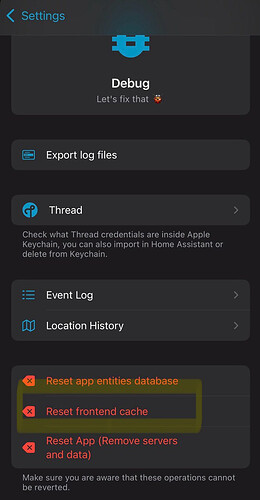

AI says:
Yes, that’s a well-known intermittent issue in the Home Assistant iOS Companion App — custom styles (especially with styles: on cards like button-card, entities, or slider-entity-row) often fail to load properly, or only apply after a manual refresh. It works fine in browsers (Safari/Chrome on iPhone or desktop), but the app’s WebView has aggressive caching that gets stuck on old frontend versions.
This has been reported multiple times in recent years (including 2025 issues after updates/restarts), and it’s usually tied to how the app handles JS modules, custom card resources, and cache persistence — especially after HA updates, core restarts, or network changes.
Quick Fixes That Usually Work (Try in This Order)
  1. Reset Frontend Cache in the App (most effective and fastest):
  • Open the Home Assistant app on your iPhone.
  • Go to Settings (bottom right in the sidebar).
  • Tap Companion App.
  • Scroll down to Debugging (near the bottom).
  • Tap Reset Frontend Cache.
  • Fully close the app (swipe it out of the app switcher) and reopen it. → This fixes it in most cases immediately.
