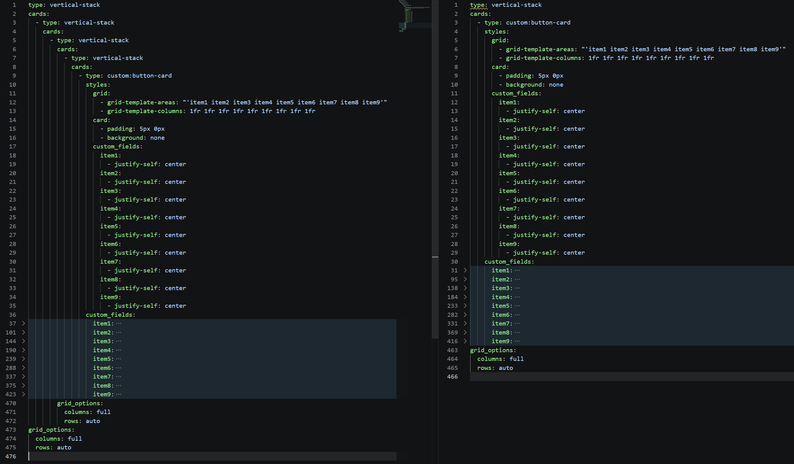

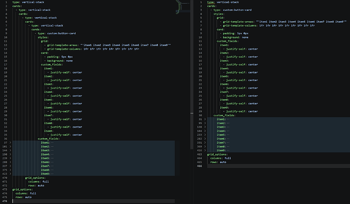

I need to retract my previous message in this topic; after pulling my hairs out for weeks I finally found the issue. For some reason I had a grid of custom:button-card's in a vertical stack, in a vertical stack, in a vertical stack, in a vertical stack. :blush: For some other reason this slows Webkit down so much the entire dashboard (to be more correct: the one view this grid was on) became unusable.
This case may be so 'rare' (who wants to pull off something this stupid like I did haha :rofl:) it's probably of no use to anyone but I'll 'report' it anyway.
