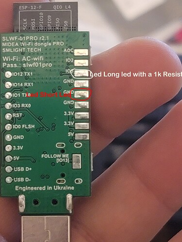

i got it working and you will need to make some changes to the code and solder a IR led inplace I will post photos and code in a bit as I finally got it working on mine
Are you saying that you soldered on an LED to the SLWF01 ? I saw examples, I think, for a wire from the SLWF01 to the main board. I think I would prefer an LED on the USB stick so that it is not attached to the wall unit.
Thanks
yes as i prefered not to have a hardwire to the Unit I added a LED i used a 3mm LED and some cat6 strands with plenty of heatshrink
Here is the code i used in esphome builder you will have to make adjustments for your needs but there are notes

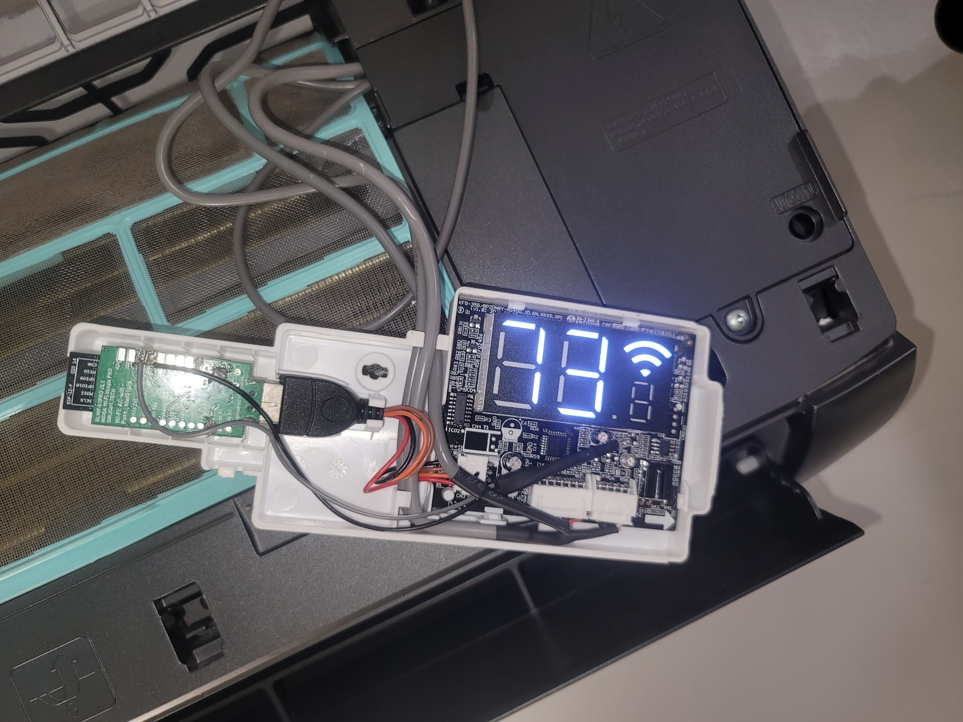

I’ll get you a photo as i’ll have to get the ladder out and open up a unit here is the LED I used
https://www.amazon.com/dp/B07LBBVJ43?ref_=ppx_hzsearch_conn_dt_b_fed_asin_title_2
Oh and yes swing works
I am a n00b with this stuff. I do have a soldering iron but I have only done very basic things with it [capacitor replacement].
Did you use a 1k resistor like this on the long LED leg between the wire and the LED?
https://www.amazon.com/BOJACK-Values-Resistor-Resistors-Assortment/dp/B08FD1XVL6
Thanks for the info on doing this and that swing works.
yes you do need the resistor and those should work fine and no problem i don’t mind helping at all don’t forget to headshrink one leg of led and resistor then cover both leds so you don’t have to worry about shorts
I created an account just now to thank you. This is the coolest and most straightforward mod!
I did literally what you suggested, including buying that very pack of IR LEDs and using an old CAT5 cable for the wires. I was too into it to take pictures along the way, but there’s no need because your photos, directions, and YAML cover it all.
