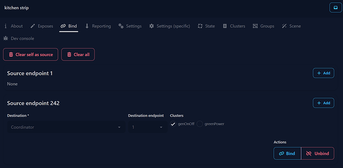

Did some digging around in the Z2M Github and someone mentioned that the bulbs establish a binding to the coordinator.
I have a feeling that’s what you’re seeing - the bulbs are still bound to your Sonoff, which is why they work with the Sonoff but not the SZLB-06.
You should be able to confirm this by opening the bulb device page in Z2M & clicking the Bind tab. If you’re still using the Sonoff, you should see something like this:

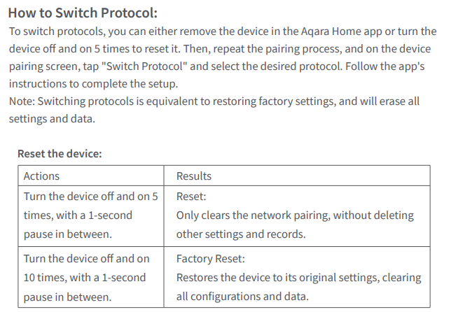

I think the cleanest way to get them to pair with the SZLB-06 is to reset the bulb itself so that it gets disconnected from your coordinator. Note that this might cause the bulb to switch back to Matter mode according to the instructions, so try it with a single bulb first:
Alternatively, take note of the current bindings, unbind the device from the Sonoff, force delete the device, restart Z2M then try to pair it to the SZLB-06. I would only do this as a last resort though, since the bulb might still think it’s bound to the old coordinator if you don’t reset it.
