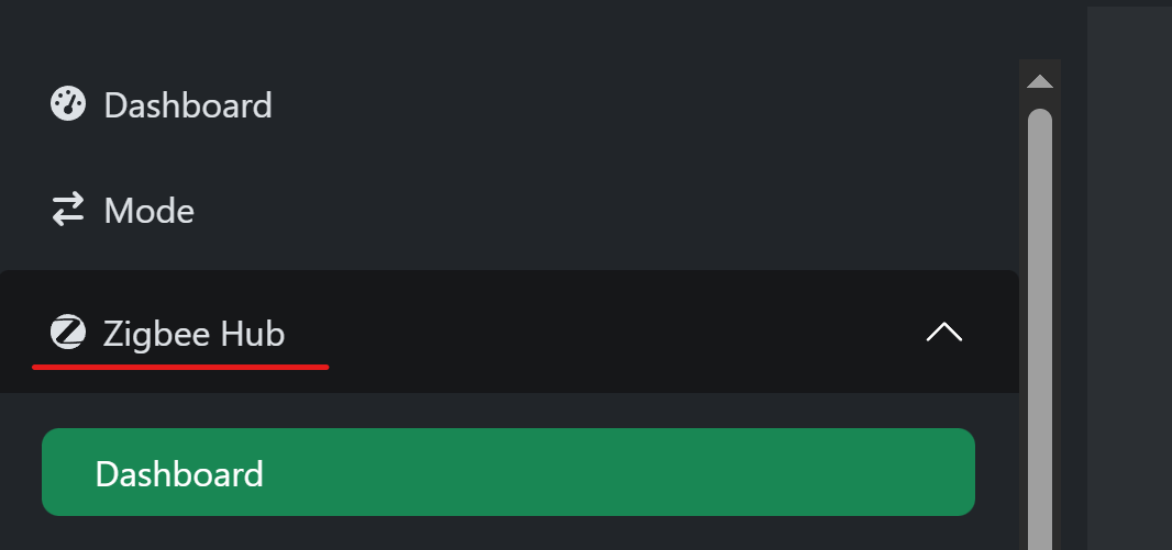

Maybe we are talking about two different things. What do you mean by ZigBee Hub dashboard?
Do you mean you are using the ZigBee Hub option in the SLZB-06 UI like I underlined below?
