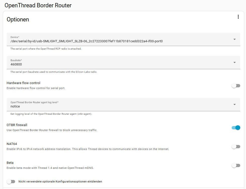

I have an SLZB-06m, directly connected to my HA green via USB. My configuration looks like this:
Starting the add-on/app results in

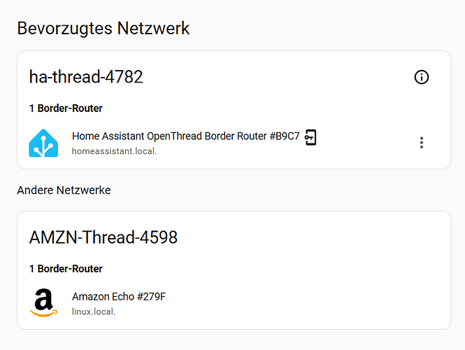

However, no OpenThread Border Router integration is discovered. In addition to that, I’m not able to sync credentials in the HA app. It fails with “There are no credentials to import”.
As you can see, there is another Thread network present, but I don’t see how this would affect the fact that I’m not able to configure the OpenThread Border Router integration while the app-on/app is running.

Here is the missing screenshot
Try with OTBR firewall disabled.
Thanks, but this has no effect whatsoever.
So, I figured out that the OTBR is already running. However, I still can’t connect any device. I’m still getting the message that there are no credentials to import.
No idea why you cannot sync the credentials. I followed the instructions in this video and it worked. Have a look: The SLZB-06 Just Got Smarter: Introducing Matter-over-Thread!
