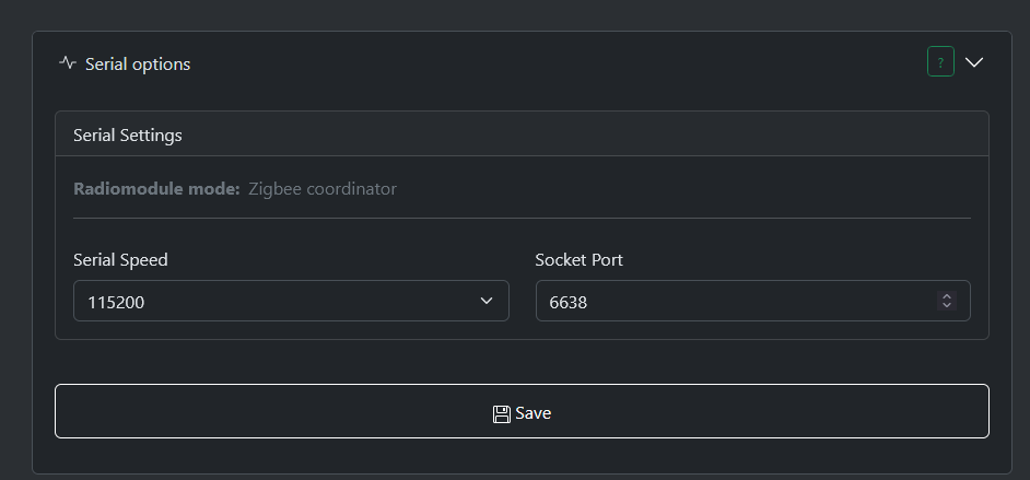

--- in the SLZB-06M control panel, I can see:
-- Mode:
- Radio [EFR32MG21] Mode
- Zigbee Coordinator: checked
- Zigbee Router: unchecked
- Matter-over-Thread: unchecked
- Socket Port: 6638, Serial Speed: 115200: both greyed out, I cannot change these values
- Bluetooth proxy mode
- Bluetooth Proxy (ESPHome based): unchecked
- Ethernet to Wi-Fi bridge: unchecked
- Connection mode
- Ethernet connection: checked
- Wi-Fi connection: unchecked
- USB connection: unchecked
- Keep ON Wi-Fi/Ethernet network & web server in USB mode: checked, greyed out
I’m on the latest SLZB firmware, the problem is not the config but the port 6638, just don’t know how to fix…
Z2M and ZHA to change the port
Thank you very much, @francisp! I changed the port to 8888 and that solved it. Phew, that wasn’t easy! Glad it’s done. Thanks again!
