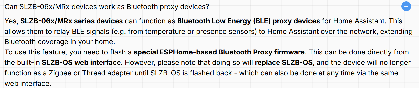

I don’t own one, but the FAQ on the product page for the SLZB-06p7U has a pretty clear warning that if you flash the proxy firmware, you’ll lose Zigbee/Thread.
Are you sure you want to do that?
Yes, of course. This is how I used my SLZB-06 that I had earlier. You don’t lose Zigbee/Thread functionality, just the fancy web UI.

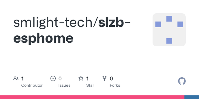

ESPHome support is now available for U devices.
