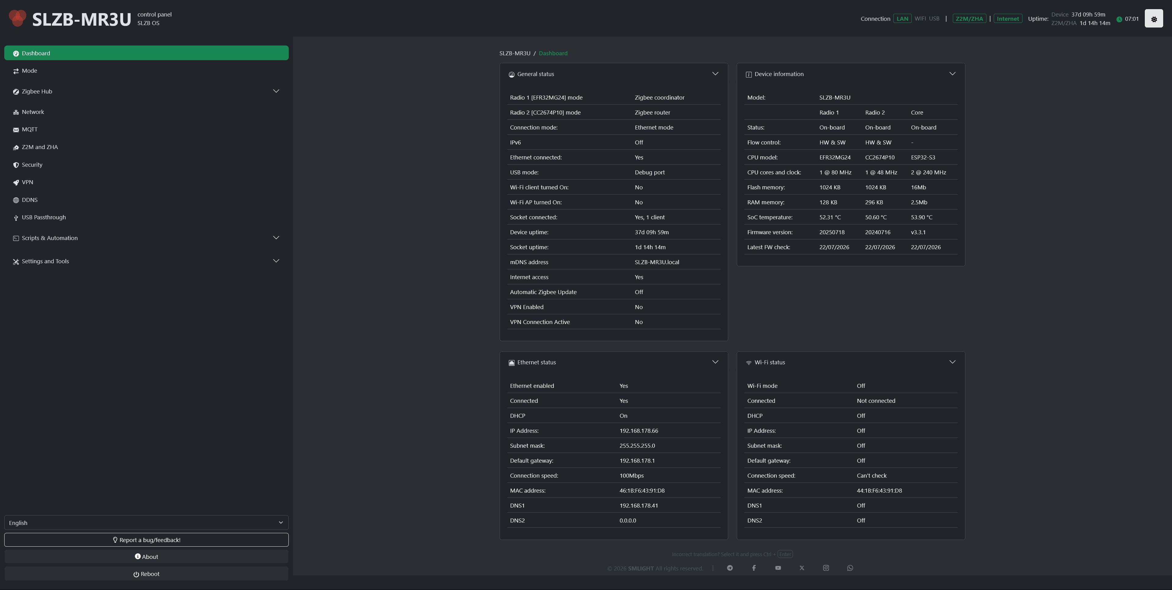

Using a MR3U here (next to a MR2 on the same server) with Z2M since Feb. 2026 without issues to speak of:
