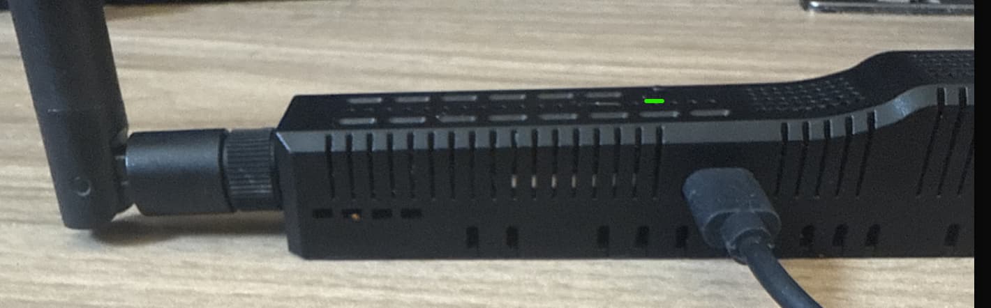

Hello, I need help. So here is the thing, months ago I did a net with z2m and mosquitto (allowing everybody through). It worked perfectly, until I try to upgrade firmware from slzb 06 m and now slzb doesn’t really do anything, only when I plug in there is one orange light and anything else, can’t even find when I plug it on the computer.

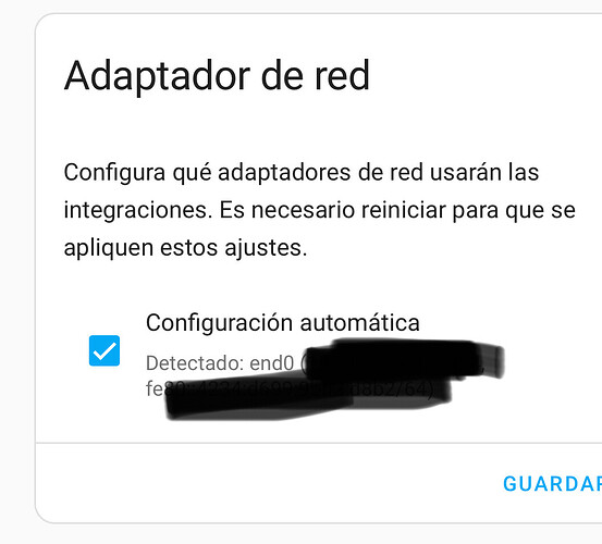

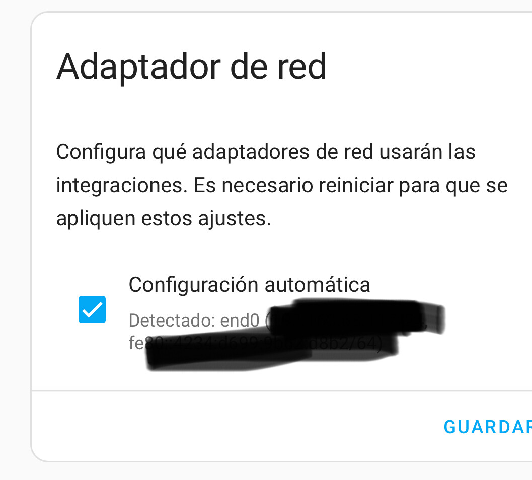

I don’t really know if there is smthng to do but in ha appears a net adapter( see photo)

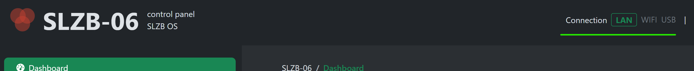

Is it connected to your network? If so, got to http://slzb-06m/ or use the device’s IP address.
You’ll get the device’s built in UI. As francisp mentioned, check the connection method I highlighted in the pic.
You can troubleshoot from there

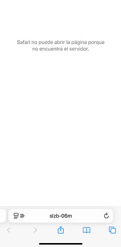

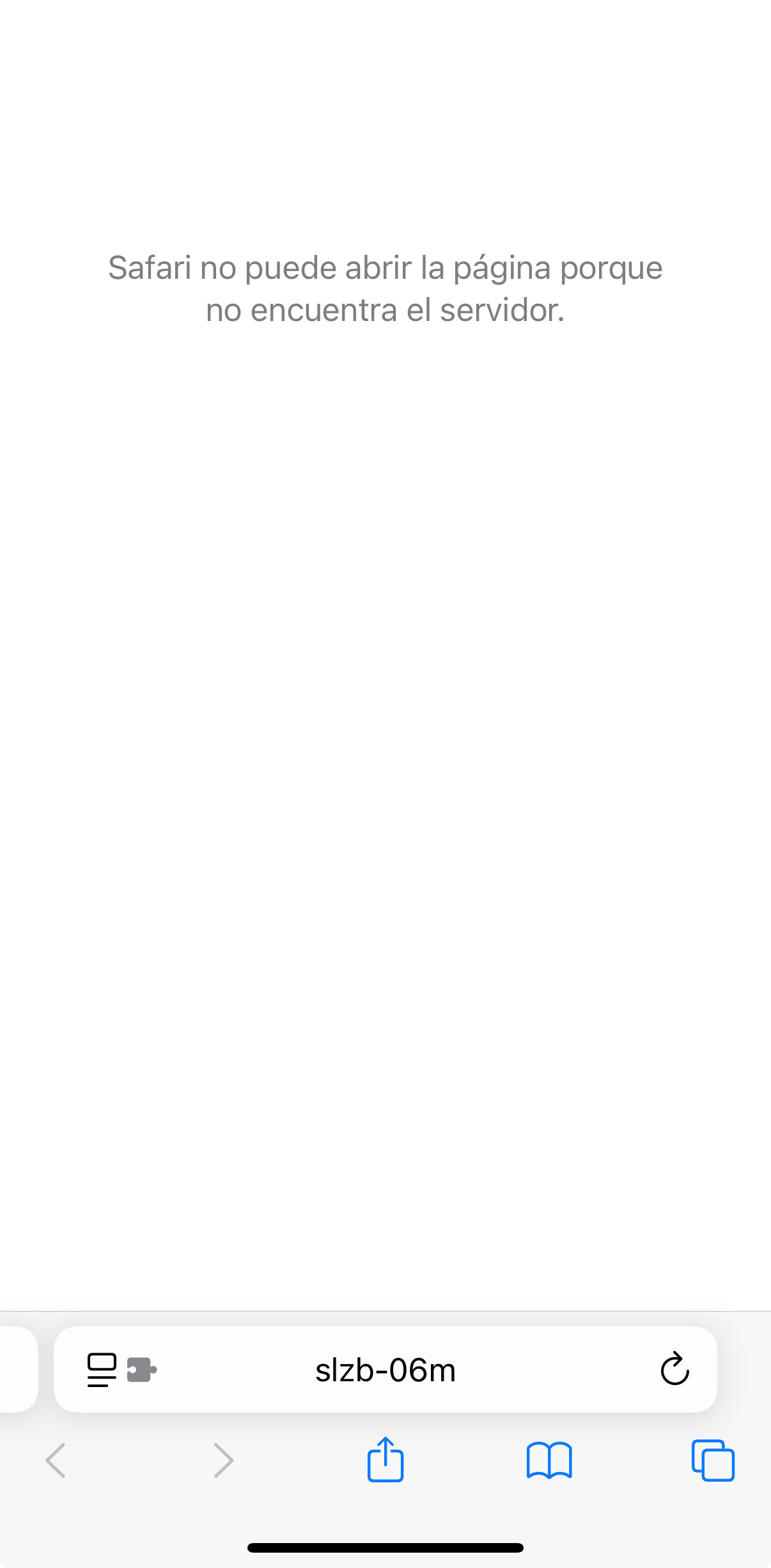

If I go to that Url… nothing. It only has on light on orange

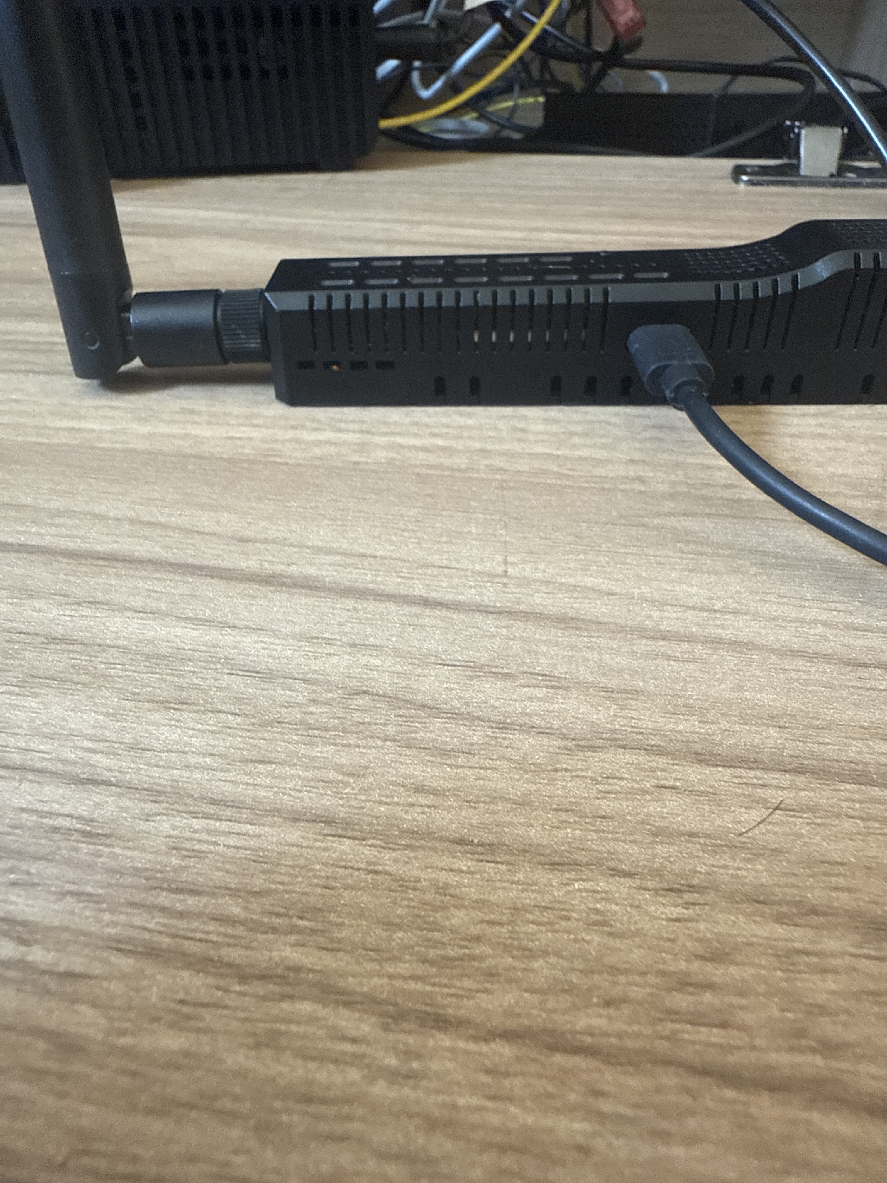

Nothing really happend… only one orange light on. No blinks…:sweat_smile:
