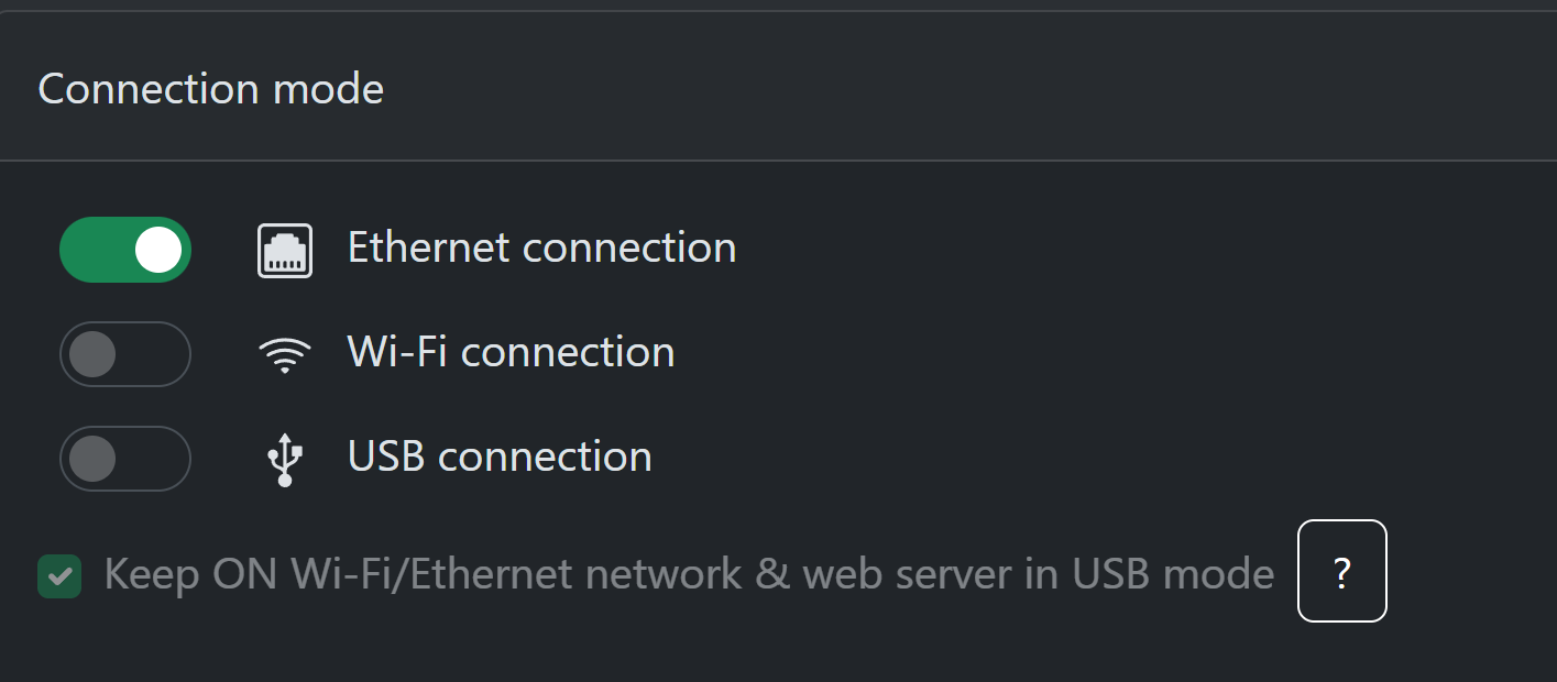

Can you access the SLZB dashboard with the IP or http://slzb-06m/ ?
If so what is the connection mode?
I think it is knackered.
The only way i can connect to it is via its own wifi and ethernet was selected. I have just changed it back to WiFi and as said, i can connect to that ok. I connect to it via the IP Address.
