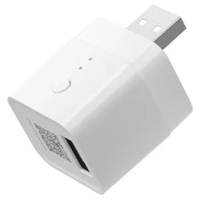

Not a bad idea. So… something like this:
(this one specifically is from Sonoff)

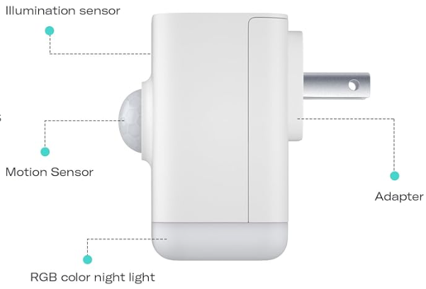

Come to think of it, maybe consider this also:
THIRDREALITY Multi-Function Night Light
This is exactly what I use as a color status indicator to know all of the doors are closed and locked each night before going to bed. I have the Matter over WiFi version and it has been working great (after a few early firmware updates a year or more ago.)
correct! I’ve ordered it and will try it as soon as all parts arrive. All parts combined it is around 13€ instead of 30€ for the Thirdreality Plug. And it is way more flexible because I can use a USB extension cable to place the light where ever I want. (cheaper and more flexible)
Re physical placement of the 3rd Reality nightlight: I don’t think they advertise it, but the AC adapter portion in the back is just a plug-on (via a USB-A) to the main unit. I think it was probably done to allow different adapters for differing regional power plugs. But seems like it could allow USB extension cable to locate the sensor/light wherever you want. I’ll have to try that with my unit; I’ll report back.
Re pricing on 3R nightlight: I’ve often found deals on my 3R devices, sometimes near half-off. I see right now a “weekly deal” on 3reality.com , with price for this device of $30 each, or $84 for 4-pack.

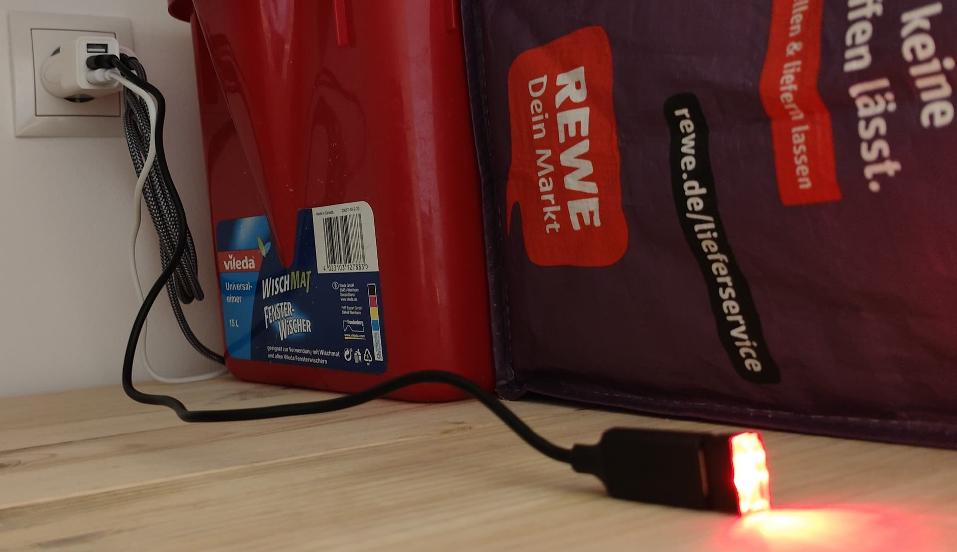

Quick update
it is awesome and customizable for different use cases for under 15€!
Parts:
  • any USB Power Plug

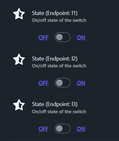

  • USB-Zigbee-Adapter: available with 1-3 slots - controllable individually in HA (s. screenshot Z2MQTT - also available as WIFI device)
  • USB Extension Cord (I am waiting for a longer one to place the small red light)

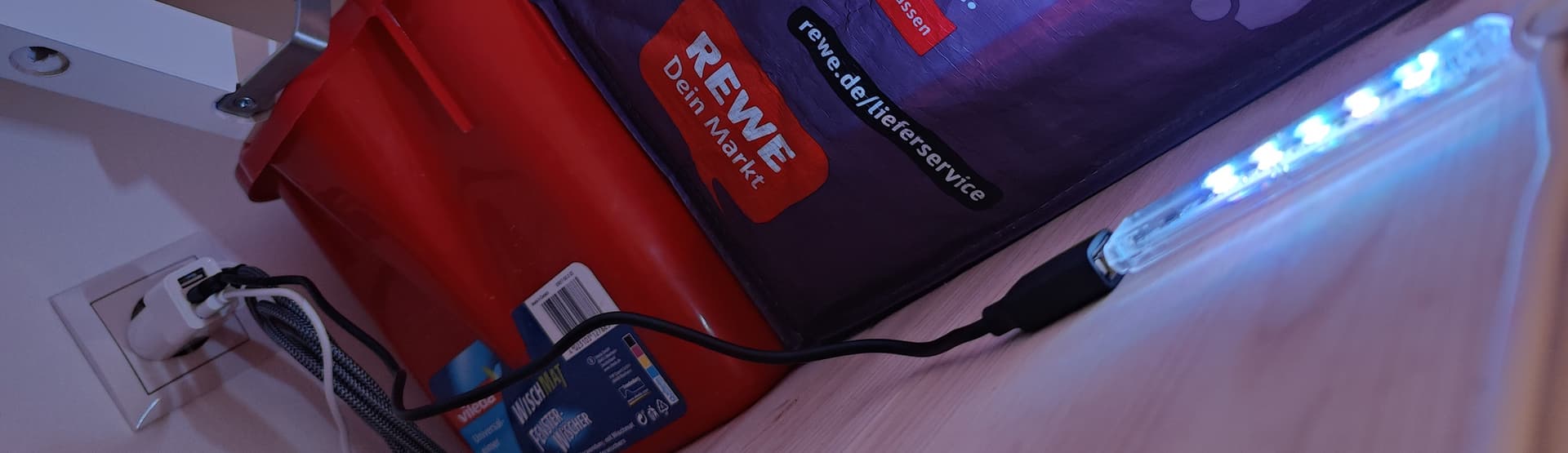

  • any USB-Light-Plug (different colors available): small red light can be placed somewhere specific and the bright white light can illuminate e.g. the ceiling above our cupboard in our hall way (quite a non-invasive/ ambient illumination compared to the red indicator)
My use case: As soon as I step into the hallway the presence detector recognizes movement and the LED strip around our cupboard in the hall way illuminates + in case a “trash”-helper is turned on the red indicator lights up next to the cupboard reminding me to pick up the trash from our kitchen when leaving the apartment. After a few seconds both shut of again. I can automate both the LED strip and the indicator with one usb-zigbee adapter (and I could automate one more usb device.
You could use three different usb lights with different colors with the same usb-adapter.
