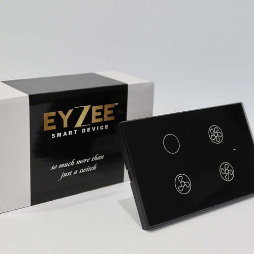

This is a good option, EyZEE fan light switch will integrate with TUYA to control the smart ceiling fan and then the zigbee switch is fully controlled in HA.
Yeah, fine for AC fans, but no support for DC fans, integrated lights or fan direction…
no need for TUYA rubbish, it’s ZigBee.
You won’t get support for DC fans from an AC connected wall switch.
