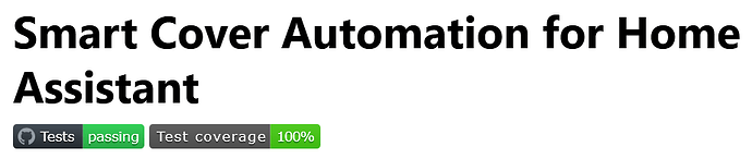

Smart Cover Automation - new custom integration
I’ve created a new custom integration to automate window covers. You can find documentation and HACS installation instructions on the website. Let me know what you think!
A Home Assistant integration to automate the control of your smart home’s window covers with a focus on quality, reliability, and flexibility.
Functionality
  • Easy to use:
    • Simple to configure, transparent and reliable operation.
    • All settings are available from the UI, no need to edit YAML.
  • Sun heat protection:
    • Close covers while the sun shines on a window to prevent the house from heating up.
    • Open covers when there’s no direct sunlight to minimize dark cave feeling.
    • The automation takes into account:
      • Is the sun shining or is it cloudy?
      • Is it a hot day?
      • Is the sun in a position to shine on a given window?
  • Manual override detection:
    • Detect manual adjustments and pause automation to avoid conflicts.
  • Lockout protection:
    • Pause automations for a cover if the door/window is open.
  • Night privacy & night silence:
    • Close a subset of covers after sunset for privacy.
    • Don’t move the covers when people are sleeping.
    • Don’t open the covers when the sun is below the horizon.
  • Plant light:
    • Define min/max positions for the covers so that plants on the windowsill receive enough light.
  • Comfort: Micro-adjustments are avoided.
  • Supported covers: Works with any cover entity that supports open/close or position control.
  • Rich language support: UI translations available for Chinese, Dutch, English, French, German, Italian, Polish, Portuguese, Spanish, Swedish.
Configuration Options
Need of sunlight and desire for shade are individually very different. The integration allows you to tailor the way your covers move according to your needs. Extensive configuration options should make it possible to implement most scenarios easily.
Try Before You Buy
Enable simulation mode, which shows exactly what the integration would do without actually moving the covers.
Note: the integration is free and open source, of course!
Monitoring the Integration’s Operation
The integration helps you understand what’s going on in the following ways:
  • Cover movements are logged in Home Assistant’s activity logbook.
  • Multiple sensors make key aspects of the integration’s status available in the UI.
  • The Home Assistant log file shows the integration’s workings in detail.
More Info & Download
Project website and GitHub repo.

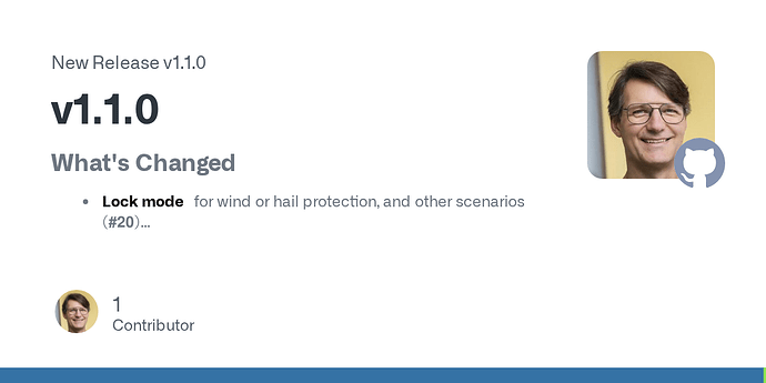

Version 1.1 is available!
It adds a very flexible lock mode, improves UX, facilitates automations, and increases test coverage from 99% to 100%.
