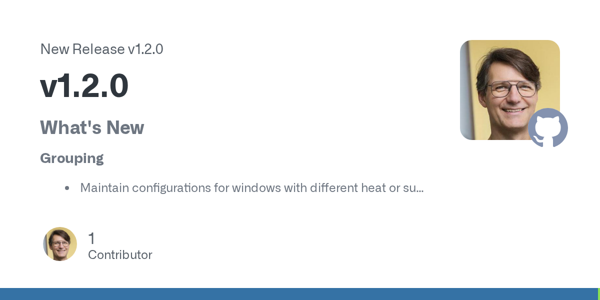

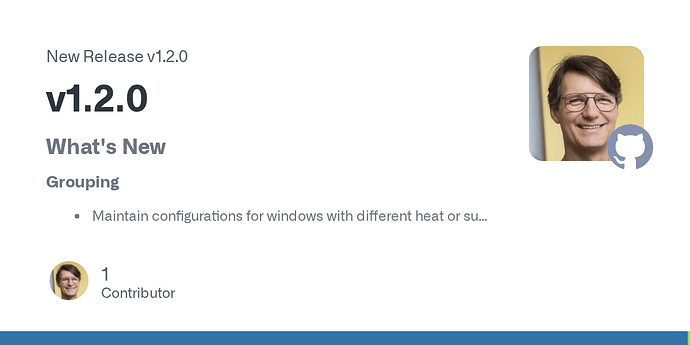

Version 1.2 is available!
You can now set up multiple instances of the integration to create cover groups, each with their own configuration.
The new version comes with additional improvements and bugfixes, e.g. Fahrenheit as temperature unit is now supported correctly.
Thanks for the multiple requests :wink:

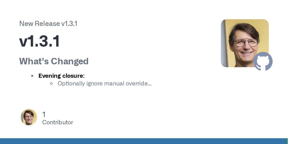

Version 1.3.1 is available!
This new version has several improvements that increase the resilience and fix bugs with the following:
  • Evening closure
  • Tilt angle control
  • Manual override detection

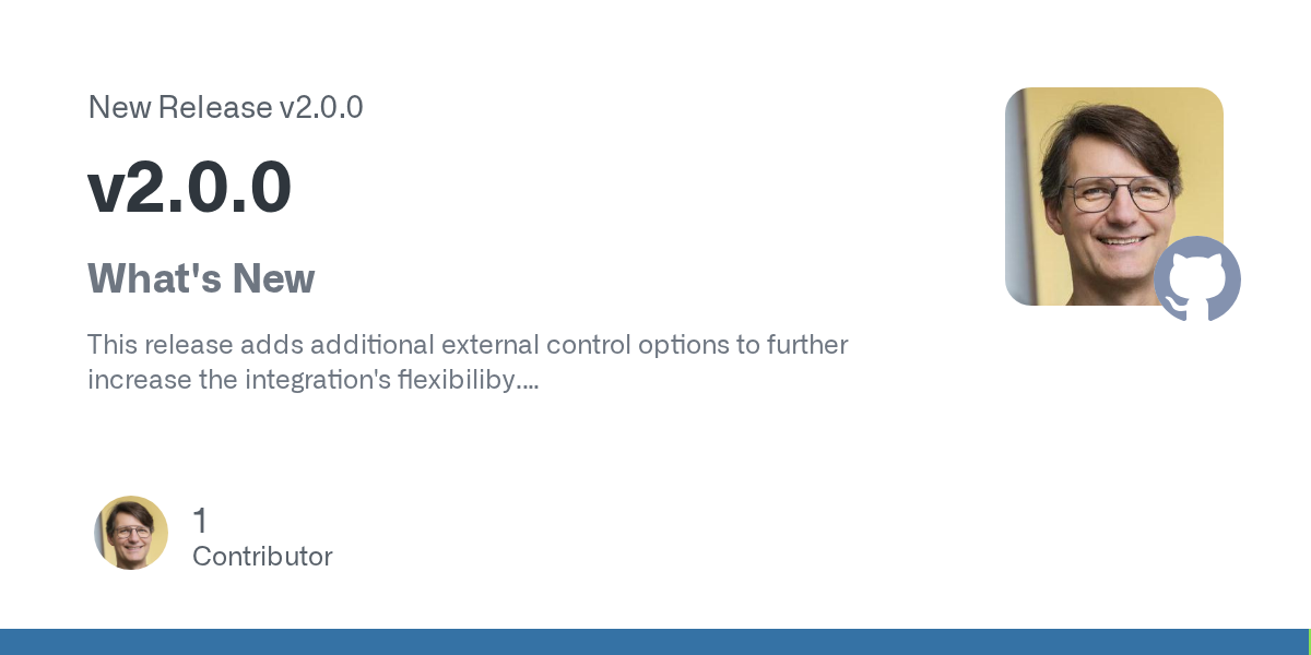

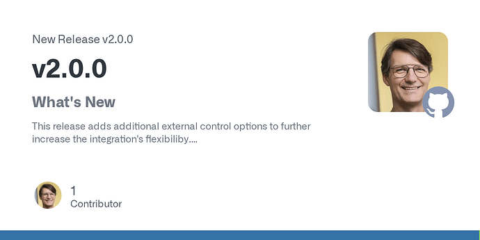

Version 2.0 is available!
This new version adds additional external control options to further increase the integration’s flexibility, specifically for:
  • Weather hot?
  • Tilt angle
In both cases, external controls are available as global and per-cover entities to allow for individual control per room.

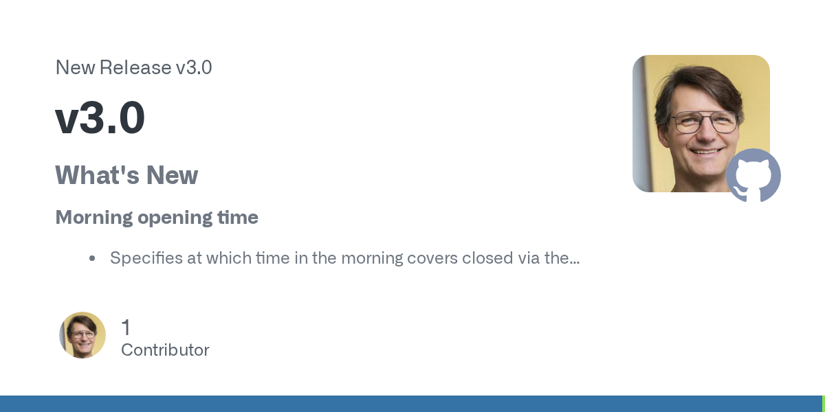

Version 3.0 is available!
This new version adds and improves a ton of things:
  • Morning opening time (complementing evening closure time)
  • Minimum daily temperature for heat protection
  • Automatic reopening during the day
  • Evening closure cover position
  • Re-close covers opened manually during the night
Please note that the integration now requires Home Assistant 2026.4.1.
