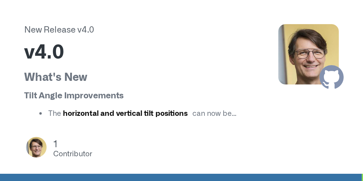

Version 4.0 is available!
This new version comes with the following main new features:
  • Better tilt angle control through additional settings
  • Offline mode
  • External mode to control evening closure time from your own automation

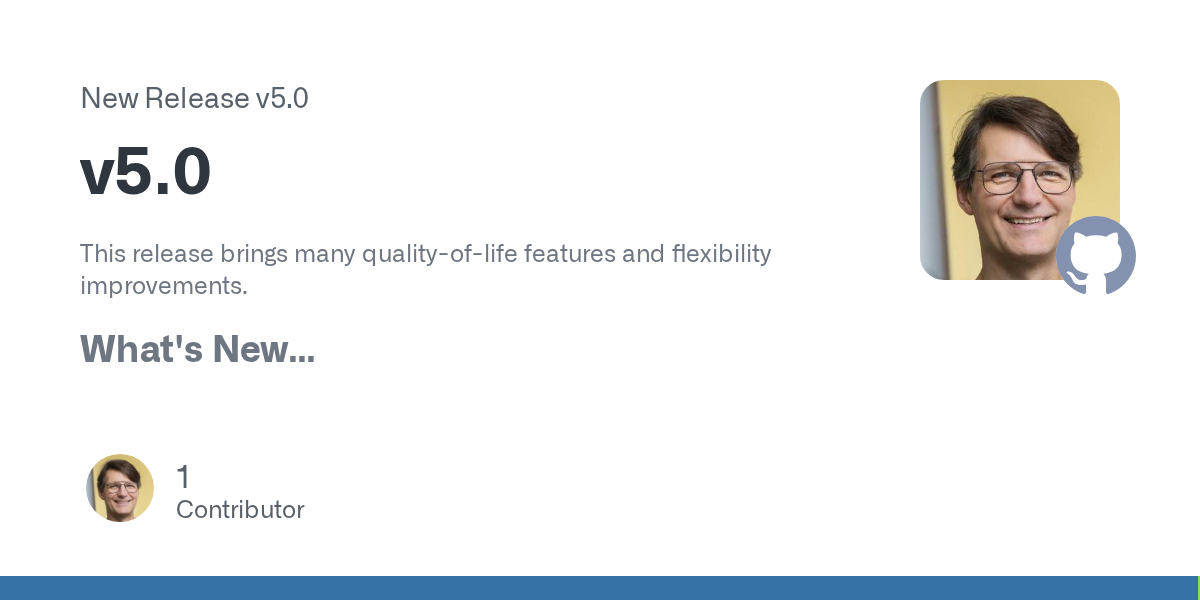

Version 5.0 is available!
This release brings many quality-of-life features and flexibility improvements:
Per-Cover Sun Azimuth Tolerance & Min/Max Elevation
  • These new settings allow you to configure the exact angles at which sunlight hits a cover from the left, right, top, or bottom.
  • These settings are available per cover, making it possible to replicate your building's geometry precisely while taking nearby trees or neighboring buildings that cast shade into account.
  • Result: The integration's heat protection can close covers accurately when they are exposed to the sun and open them otherwise.

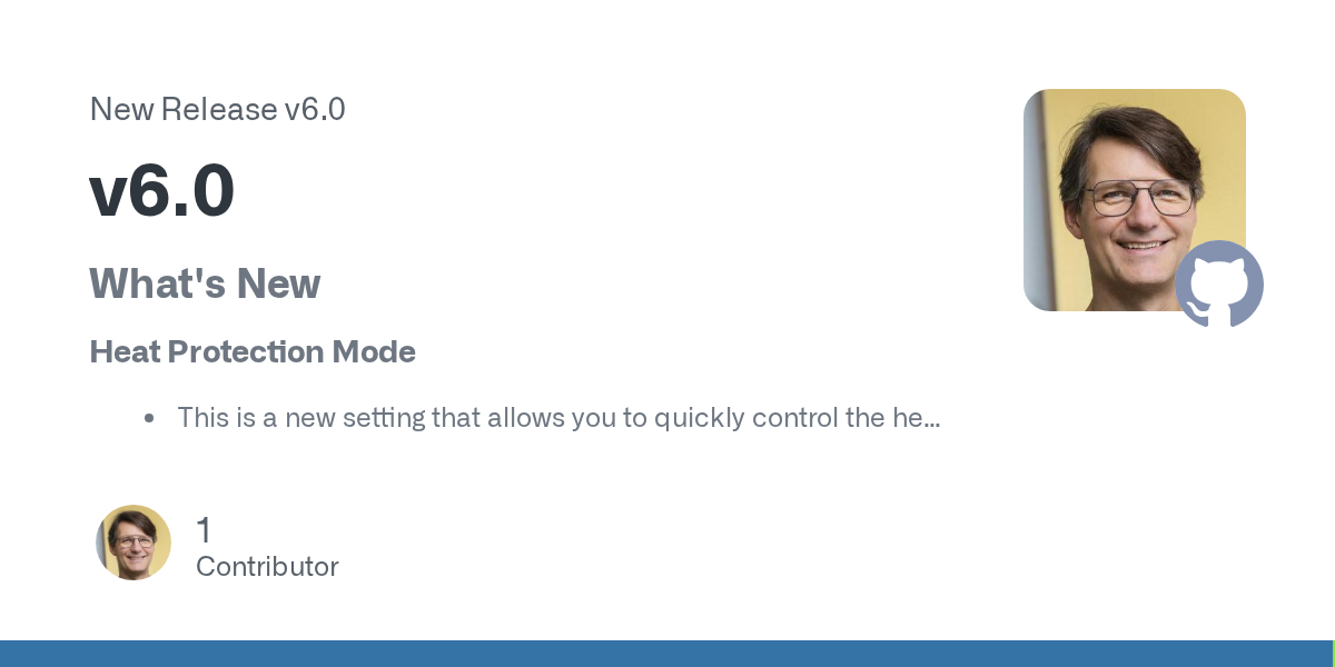

Version 6.0 is available!
This release adds a heat protection mode setting to the UI and brings various other improvements.
Under the hood, a lot was changed to properly track automation-managed cover state. Please note that after an upgrade from an earlier version while covers are closed, it may be necessary to manually move covers to the open position once.

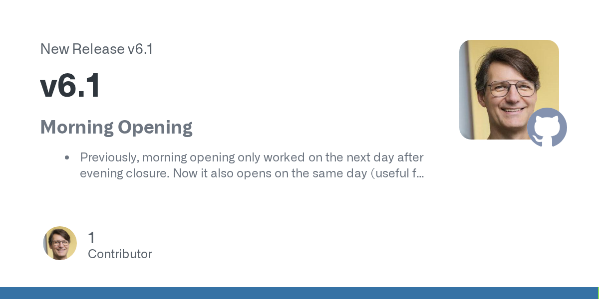

Version 6.1 is available!
This release adds some minor improvements and gets rid of a Home Assistant deprecation warning.

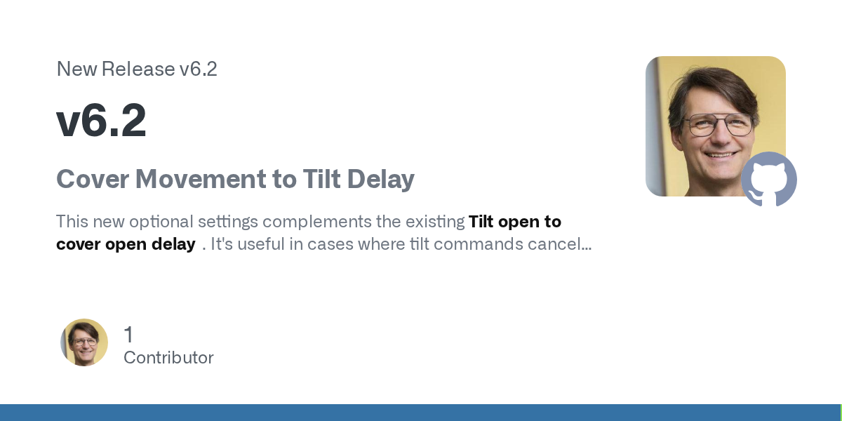

Version 6.2 is available!
This release adds Cover movement to tilt delay, a new optional setting that complements the existing Tilt open to cover open delay. It’s useful in cases where tilt commands cancel cover movements (e.g., with Somfy blinds).

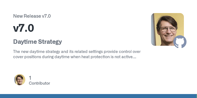

Version 7.0 is available!
This release adds daytime strategy. It provides control over cover positions during daytime when heat protection is not active. Previously, the integration always opened the covers on such “normal” days. This is now but one of several strategies:
  • Let light in (default)
  • Privacy
  • External control
