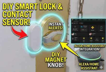

  • Custom 3D-printed lock magnet holder
How It Works
The normal door sensor detects:
  • closed = magnet near sensor
  • open = magnet away from sensor
For lock detection, I added a custom magnet setup inside the door knob mechanism using a 3D-printed holder.
This lets Home Assistant detect:
  • locked
  • unlocked

Installation Notes
  • Sensor alignment is very important
  • Magnet should face the sensor line properly
  • Initial knob-mounted magnet setup was unreliable
  • Custom 3D design solved it
PIC
3D Design
https://makerworld.com/en/models/1910582-dumb-knob-to-smart-knob-zigbee-home-assistant#profileId-2048724
