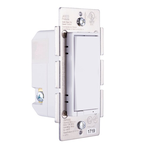

Fan switches that control speed are available
