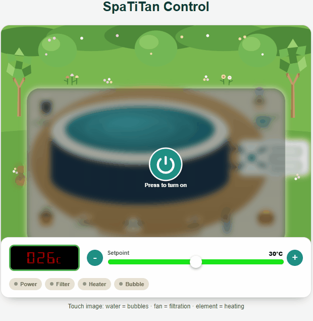

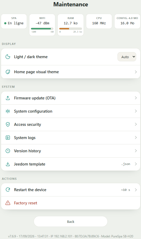

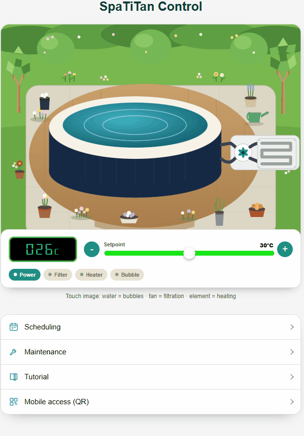

I’m back with a massive system and visual update via its dedicated web page:
fonc en
saison en
Maintenance settings

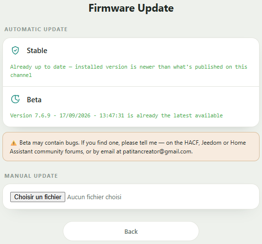

Updates are now available remotely:

Looks fantastic how do I update my version I’m on v6.1.0 and only able to update via a file
