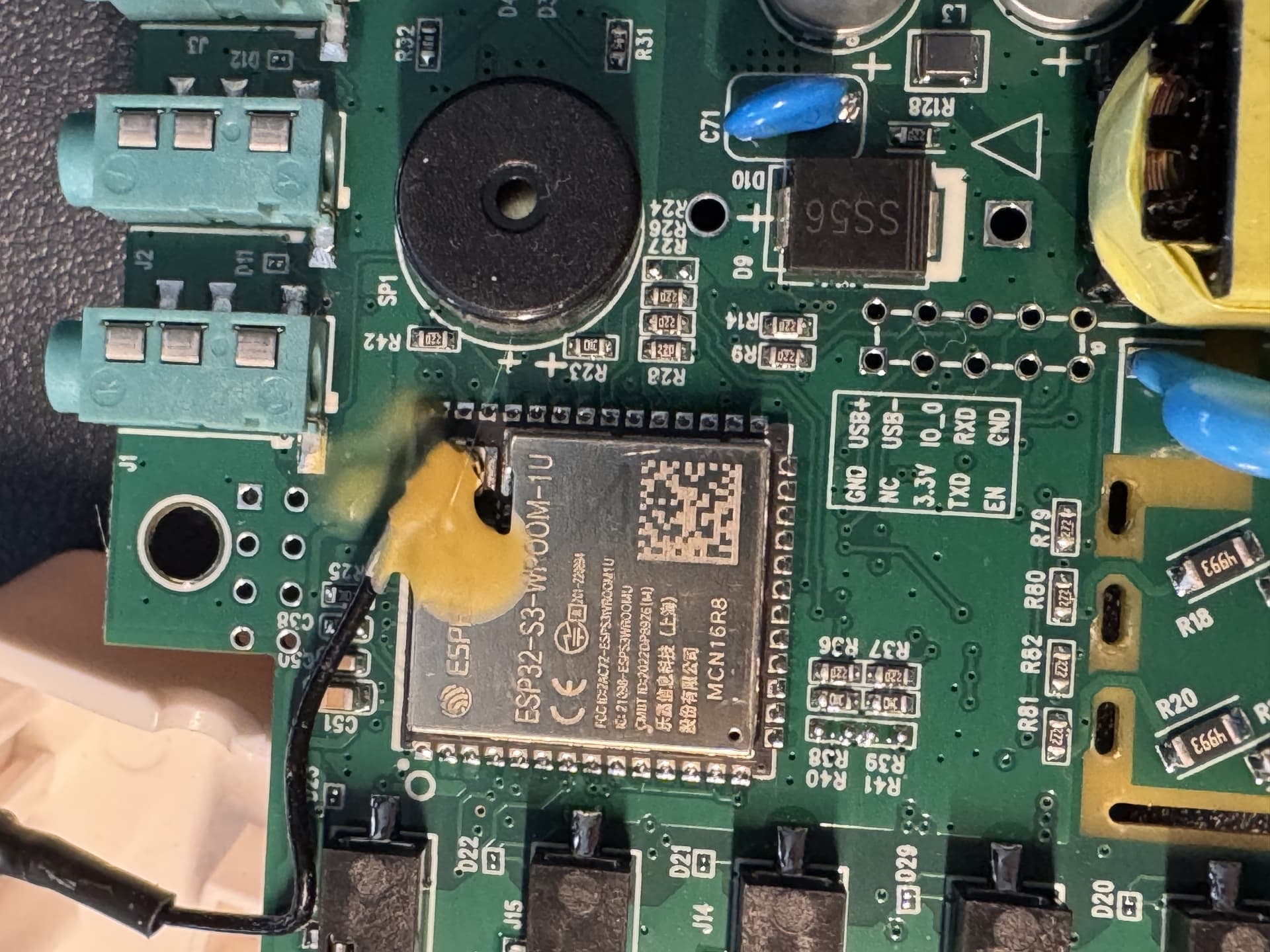

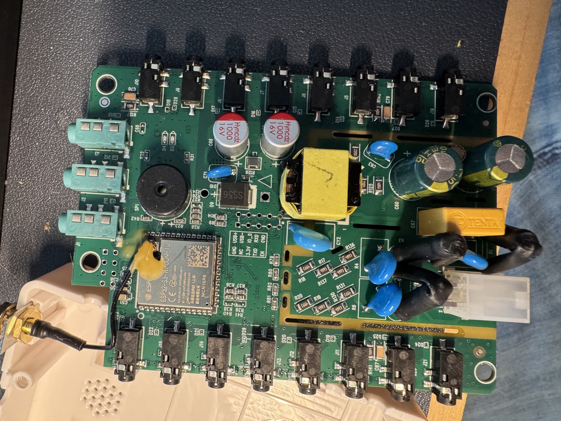

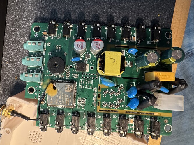

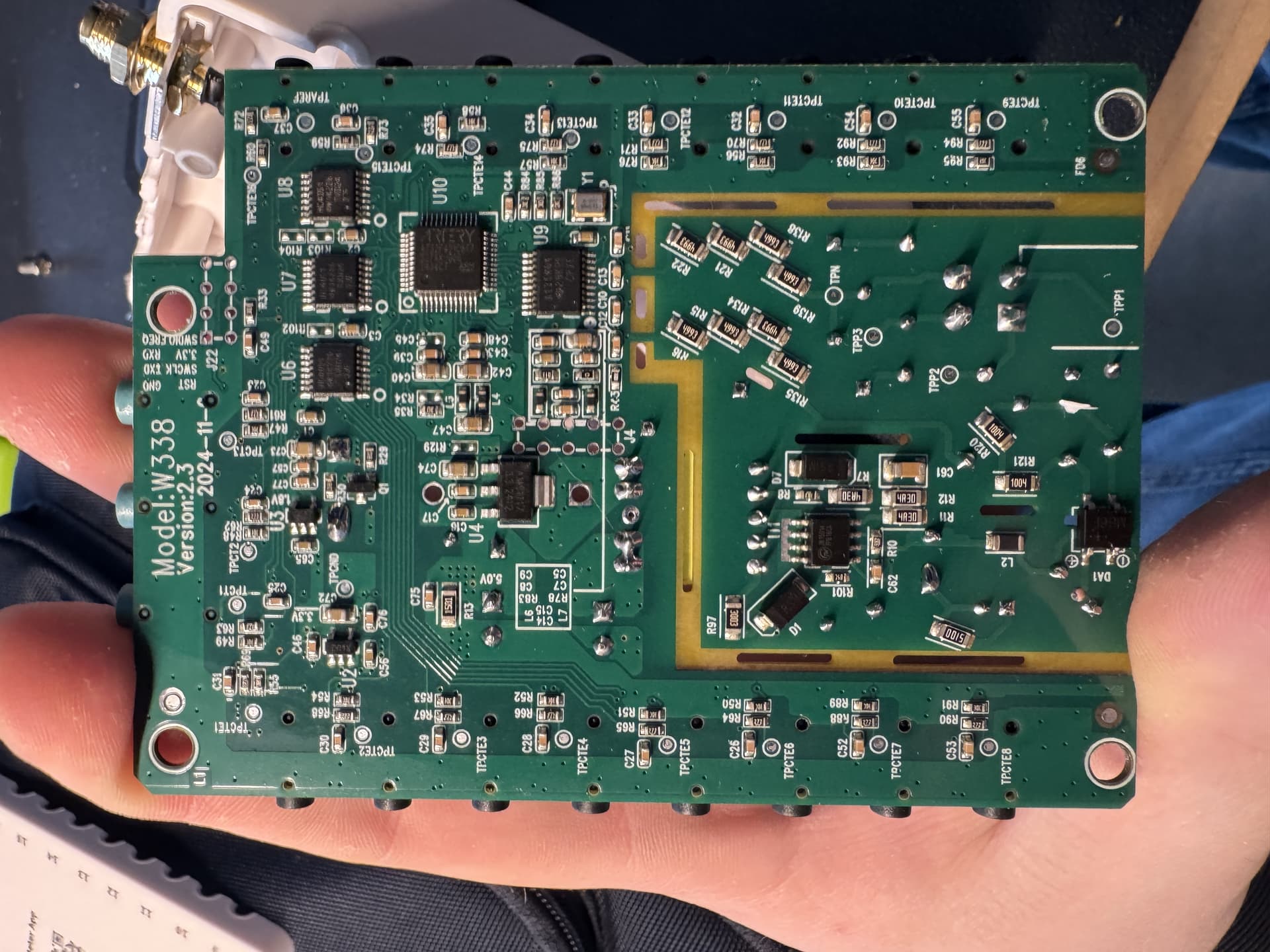

Just chiming in to say I was able to get this working with local MQTT, it seems I have a newer revision of the board that comes with the Home Assistant compatible firmware out of the box which is nice. I have attached pictures of my version 2.3 board below. I also connected the device to my Mosquitto broker addon using a HA User for username/password. Then I used the MQTT explorer application to get the serial/mac needed to edit the home assistant configurations linked by the manufacturer.
