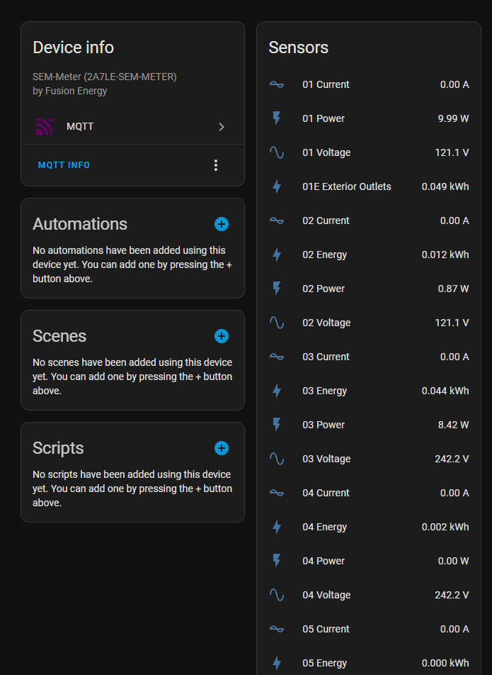

Having some issues getting up and running. YAML is complete and “checks” out.
I assume the app login and HA broker login are the same and the app uses the broker IP (assumed to be the HA IP).
Do all MAC addresses in the yaml need to be updated with the MAC displayed in the app?
Kinda stuck.
In the app, open the device settings and click Home Assistant. Enable the custom MQTT “Use your own server” and enter the “URL” of your broker (not just the IP address) as shown below, and the username and password for your broker login (if you are using HAOS, I believe this will be your HA login) and click Confirm.
Assuming you have MQTT setup correctly in HA, then go to Settings → Devices and Services → MQTT → Configure. Where it says “Topic to subscribe to” enter SEMMETER/# and click START LISTENING.Within 30 seconds you should see an entry like the one below. The MAC shown on the first line is the MAC that should be used for all the YAML sensor definitions. If you don’t want to define sensors manually you can run the script I posted above.

Finally got it.
Need to use HA credentials, port 1883, and the HA IP in MQTT re-configuration, then set the same in the SEMMETER app. The key was port 1883.
Or you can use mqtt001.tumblevd.com as the broker URL in the MQTT re-configuration and set the cloud option in the app. Same credentials and port across HA and the app.

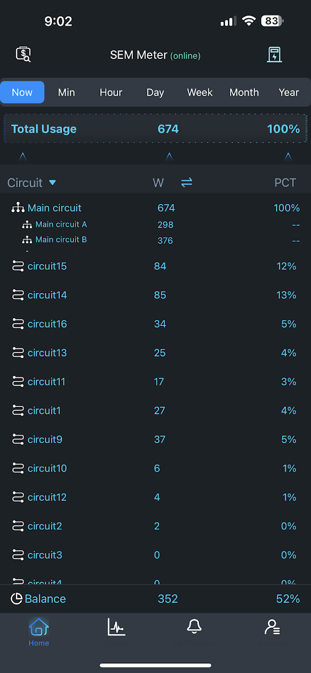

Just received the unit yesterday. I have set up the app and HA using their MQTT server. May go to local MQTT later but it is very helpful to use both their app and HA to trouble shoot and identify all the circuits (I have 25 circuits so I need to choose 16 to monitor).
It is pretty straightforward to use their MQTT server. Just need to add a bridge in the Mosquitto Broker. I have a perl script to generate the mqtt.yaml file which was then included in the configuration.yaml. I can share my setup if anybody is interested.
The bottom of the app screen has the “Balance” percentage which is the circuits not monitored by the CTs. 52% means a lot of adjustments are needed :slight_smile:
