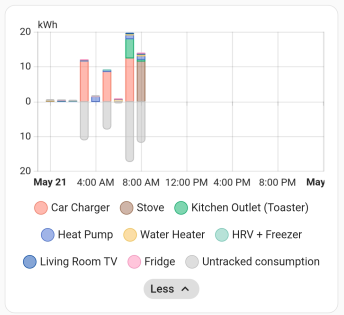

I ended up using helpers through the Home Assistant UI to count the energy used, so I could reset it at the end of the month. I fed the SEM-Meter provided sensor.active_power (W) into a trapezoidal rule integral helper to create the energy metric (kWh), and then I used a Utility Meter helper to make sure it’s reset at the end of the month. I added the Mains electricity Utility helper (total) as the Grid Consumption in the Energy configuration in HA, and I added the breaker Utility helpers as Individual Devices in the Energy configuration.
My problem is this, there is a large amount of “Untracked Consumption” that mirror my consumption, further, appliances are using a lot more electricity than anticipated. For example in this screenshot, it shows the car charger (red) and stove (brown), these peaks are huge and when they fire up there is untracked consumption as well:
As a detailed example: At 5:00-6:00 Home Assistant is reporting that my car charger used 8.6kWh, but the SEM-Meter app is reporting only 0.37kWh. At 7:00-8:00 Home Assistant is reporting that my car charger used 12.5kWh, however in the SEM-Meter app it shows 0.094kWh.
If I use the SEM-Meter provided sensor.energyin (kWh) it seems to be the right number (instead of using the Utility helper). I added both my Car Charger using the utility helper and the car charger EnergyIn metric to HA’s Energy Panel “Individual devices total usage” bar plot, and it shows that the Utility meter use is huge compared to the EnergyIn metric (which is probably right).
What am I doing wrong? Why is Utility meter giving me weird numbers? What did I do wrong? Any help would be great! Thanks!

Your Utility Meter entities should be based on the energyIn of SEM Meter, not the active power. The active power varies in a wide range and cannot be translated into energy accurately using an HA template.
Trapezoidal rule integral requires high frequency sampling, not the 30 second or even the 2 second samplings from SEM meter can give you good results.

Thanks, I will give that a try. Figure I need to delete out the old Utility helper and remake it, or could I just change the input sensor on the current utility helper?
I will delete all the integrals, guess they aren’t needed! Thanks!
Edit: Eh, I’ll just remake them to be sure.

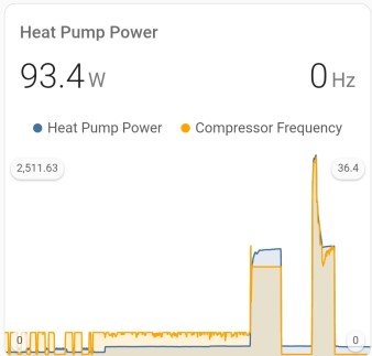

Mine also got updated, and crushed my ApexChart card I had. Way too many data points and now all of HA is working at a snail’s speed. I disabled the card, and everything was good. Anyone have a good way for me to plot power use versus compressor frequency?
The default energy dashboard works quite well. But you can only go down to hourly.
Thanks! I ended up using Mini Graph Card and it works great. The issue was with ApexCharts, apparently there’s some lag issue that the developer never solved. In Mini Graph Card I set my sampling to 1 point per minute, and it works great. Zero lag at all. Highly recommend Mini Graph Card for this energy meter. In fact, the energy meter has been great so far too.
