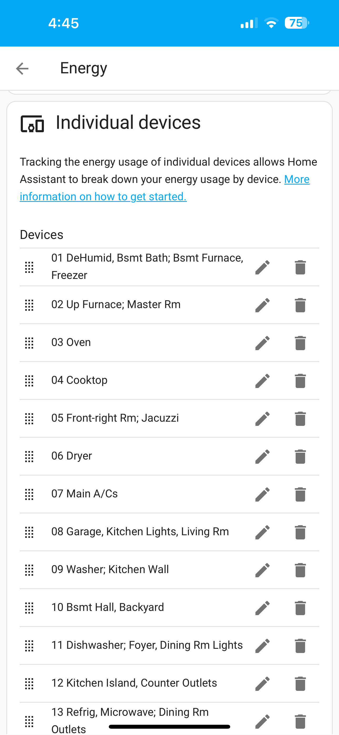

If I were you I would choose ALL my circuits. Just because you only have 16 circuits doesn’t mean you can only chose 16 wires. As long as they are on the same phase you can run a couple of wires through one CT clamp and it will capture data of more than 1 circuit at a time.
I actually have 36 breakers and 25 is after combined some of them. Can I get it down to 16? Probably, but would lose the meaning of some of the readings. I just chose to skip those circuits with low usage. My data from the last couple months shows that I can capture 98-99% of all usage with the 16 clamps. Not bad.

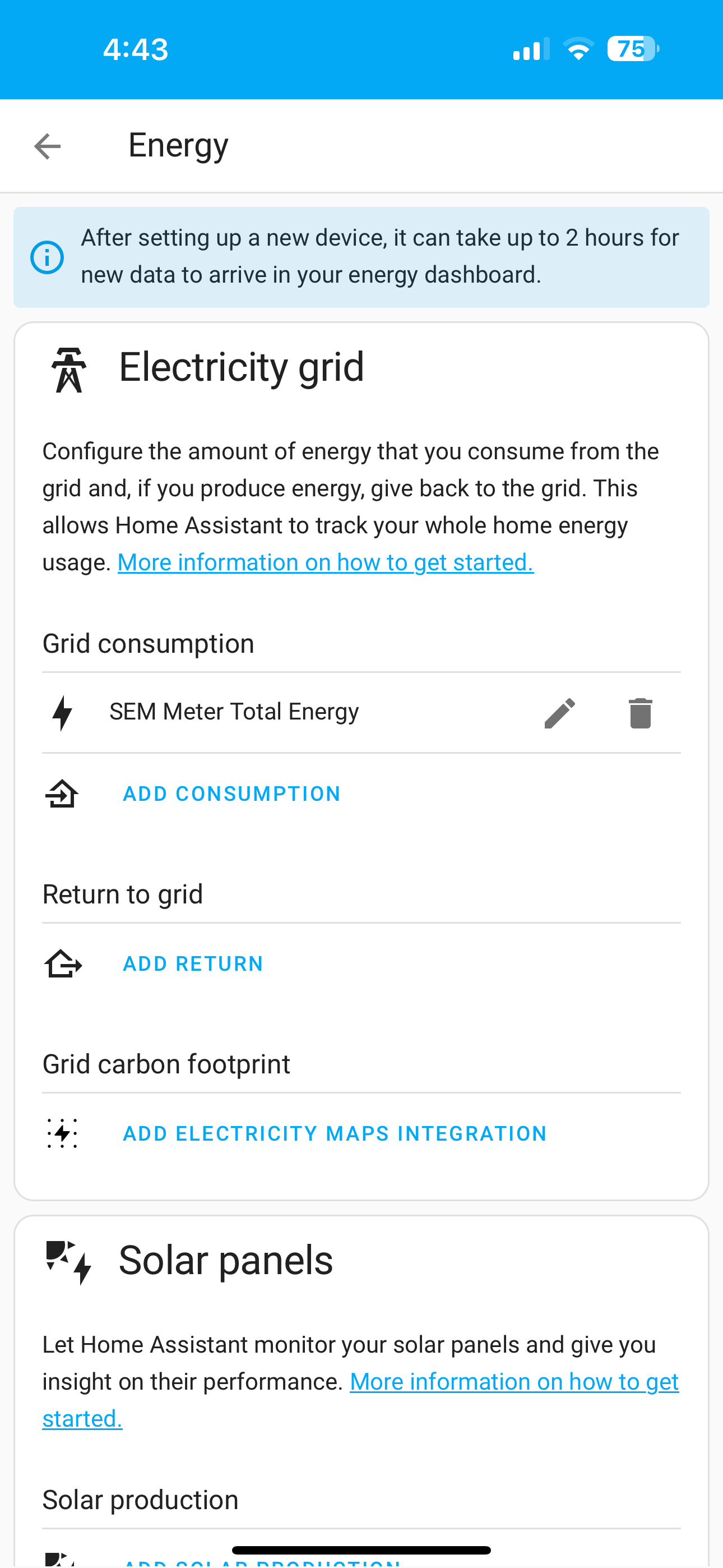

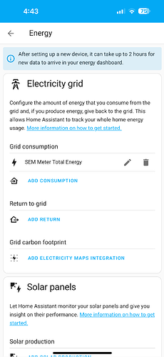

I copied from this and the mqtt sensors are working great. I was expecting to see the utility_meter.yaml stuff making everything show up in the energy tab, but I see nothing new there. Did I do something wrong, or am I expecting the wrong thing?
The utility meters only show up at the Helpers tab. For the Energy dashboard you need to open the Energy Configuration and add the Sem Meter total energy to the grid and the circuits to the individual devices. See attached screenshots.
