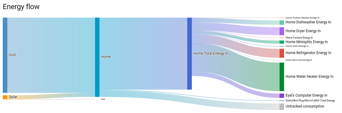

In mine, for example, I have my energy meter, the one provided by the energy company, that’s “grid”. “Home Total Energy In” is the sum of the mains clamps from the SEM meter. Then I set up, for example, the dishwasher’s energy in to be downstream of the Home Total Energy In. That means that whatever energy used by the dishwasher is subtracted from the Home Total Energy In. In shows in the graphic that the dishwasher energy is coming from the home total energy. The part of the Home Total Energy that has no downstream meter, that’s the left over that is untracked because I don’t have enough clamps.
You can configure anything to be upstream or downstream of anything in that energy dashboard. So if you have two different SEM meters and the clamps go to different panels, it doesn’t matter. Just get the measurements and then, in HA, configure it so that the correct measurements are upstream and downstream of the correct items. And it’ll all just work out.

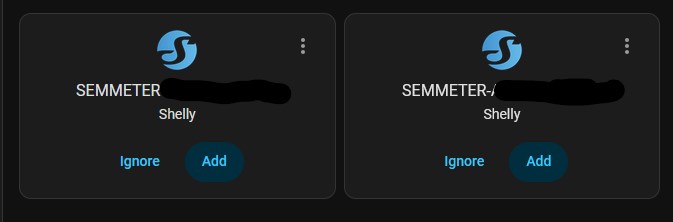

Recently my meters have been showing up in the device page as a shelly device. Is this a new firmware feature or something? I don’t want to add them in case it screws anything up
