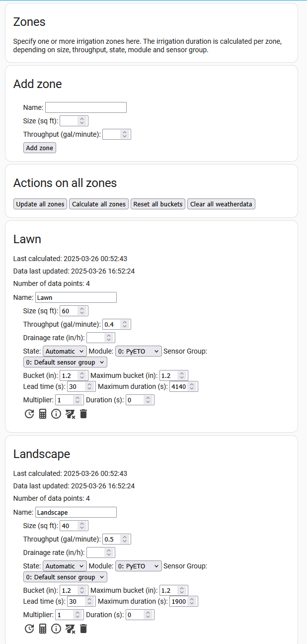

Now the bucket has been stuck at 0.0 for the past few days. Could I pay you to review everything and get it working properly? I quite don’t understand what is going on.
I did find this in the logs, but it doesn’t indicate what is ‘missing’
This error originated from a custom integration.
Logger: custom_components.smart_irrigation
Source: custom_components/smart_irrigation/init.py:1154
integration: Smart Irrigation (documentation, issues)
First occurred: 12:38:43 AM (2 occurrences)
Last logged: 12:38:43 AM
Calculate for zone Lawn failed: no data available.
Calculate for zone Landscape failed: no data available.

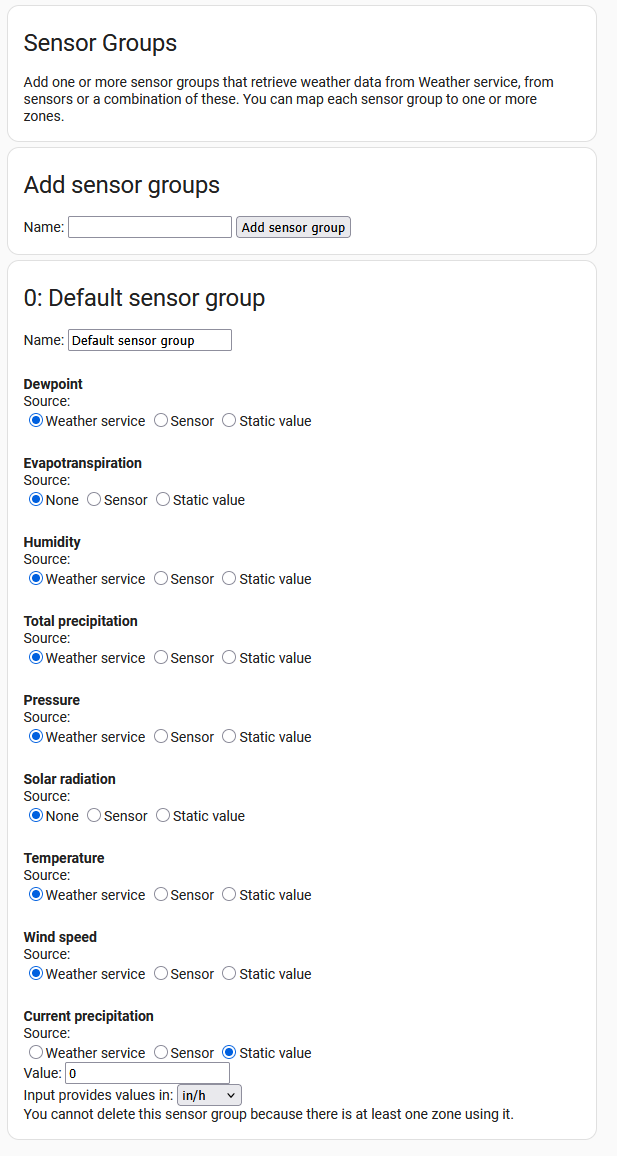

No need to pay me! This error indicates that there is no data for the zone. Can you share screenshots of your sensor groups screen?

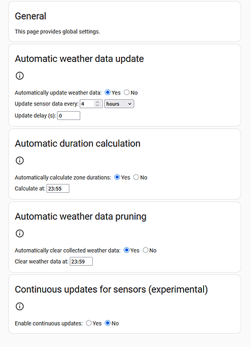

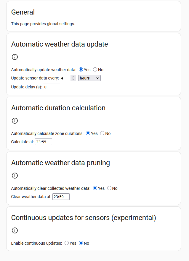

These are my current settings
updating every 4 hours is very low frequency, you are going to miss a lot of weather patterns that way.
The rest looks good to me, please confirm your API key for OWM is valid by making a test call to their API.
I had it set to 1 hour, I was afraid that it might have been duplicating the rainfall data causing the excessively large buckets.

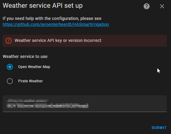

I have a problem with configuring the integration with the API-Key of open weather map. The API-Key is newly generated, but it says the version is incorrect or the API-Key, see photo attached. What are the next steps i can try?
You could have read the docs… Installation: Configuring weather service | Smart Irrigation says: “If the key does not work right away, no worries. The email you should have received from OpenWeaterMap says it will be activated ‘within the next couple of hours’. So if it does not work right away, be patient a bit.”
So, did you indeed wait a couple of hours before trying it or is the key new?
Yes, the key is already at least five days old, so it should be valid by now. The Pirate API key worked immediately, but since the PyETO calculation is returning abnormal values, I’m not sure if the data is accurate for my location. I know the OpenWeather app accesses a local weather station, so I wanted to try using that approach instead.
