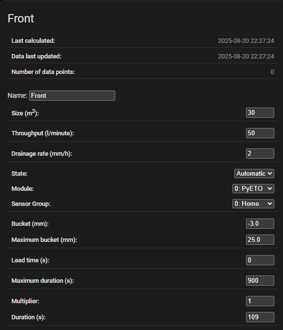

Hi guys! I have the following situation and I don’t know what can I do. I have my lawn split into 3 zones. The issue is that all of them are affected different by the sun, resulting in a zone that is almost burned. Is there any way to “speed up” the draining of a bucket from a specific zone?
well, did you check the size and throughput for your zone? if so, change the multiplier and or drainage rate to make it get more water
The size and throughput is correct and I also played a little bit with the drainage, but this will affect only when the bucket is on a positive value. My issue is not the quantity of water, but the speed of bucket drain.
If your zone is not getting enough water, then the size is too small or the throughout is not high enough. The throughput is supposed to be the throughout of the sprinklers in that zone. The multiplier is the only one Tha twill help you bump in the duration but mathematically speaking your zone is getting the water it needs.
The zone is getting enough water ( ~15-20L per irrigation), the problem is that based on the calculation ( PyETO with temperature estimation ) the bucket will dry out and get to -15L in more than 5 days. From what I know the desired situation should be 15-20L on every 3-4 days on hot days (more than 30C).
Initially I thought that is taking wrong temperature based on my location, but I checked and it seems to be the right one.
Now my automation is to run at -20L on bucket or 3 days, but usually is triggering the 3d rule.
