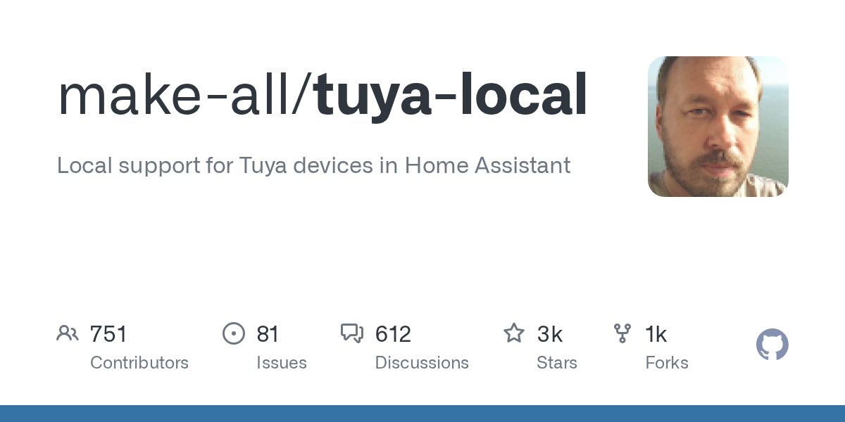

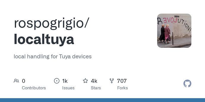

For Tuya wifi devices, you can use either of the below unofficial integrations if you install HACS:
(Don't ask me which of these is better - I don't use either one for...reasons)

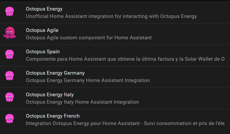

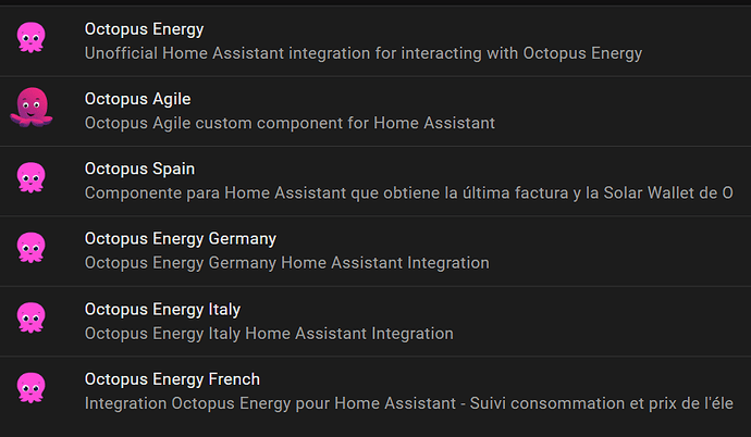

PPS - HACS also has a bunch of Octopus integrations. I think this one is UK only, but not 100 % sure, though it supports Cosy 6 & Cosy 9 Heat Pumps. If you're not from the UK, there are other variations for different countries available in HACS:

As mentioned above, in the case of Tuya there are other local alternatives such as the HACS integrations tuya-local and localtuya, which allow 100% local control and therefore the possibility of subsequently blocking data from being sent back to the Tuya cloud by other means. Configuring Tuya devices with these integrations is not always straightforward — sometimes you need to manually retrieve the datapoint IDs, their possible value ranges, and their types beforehand using the Tuya cloud API, in order to enter them manually when adding a device in localtuya or tuya-local.
The issue I ran into with both of these integrations (not the integrations's fault, its how the Tuya firmware are made) is when devices would sometimes reset themselves to factory defaults on their own. For example, during power fluctuations, which commonly occur during a power outage, a factory reset is sometimes triggered because the voltage fluctuations mimic the Tuya reset procedure (rapidly switching on and off the power 3 times). The device loses its local key and therefore disconnects from the integration as well. To recover a new local key, you have to re-pair the device with the Tuya cloud, retrieve the key again through the cloud API, and re-add the device in the integration, which is time consuming.

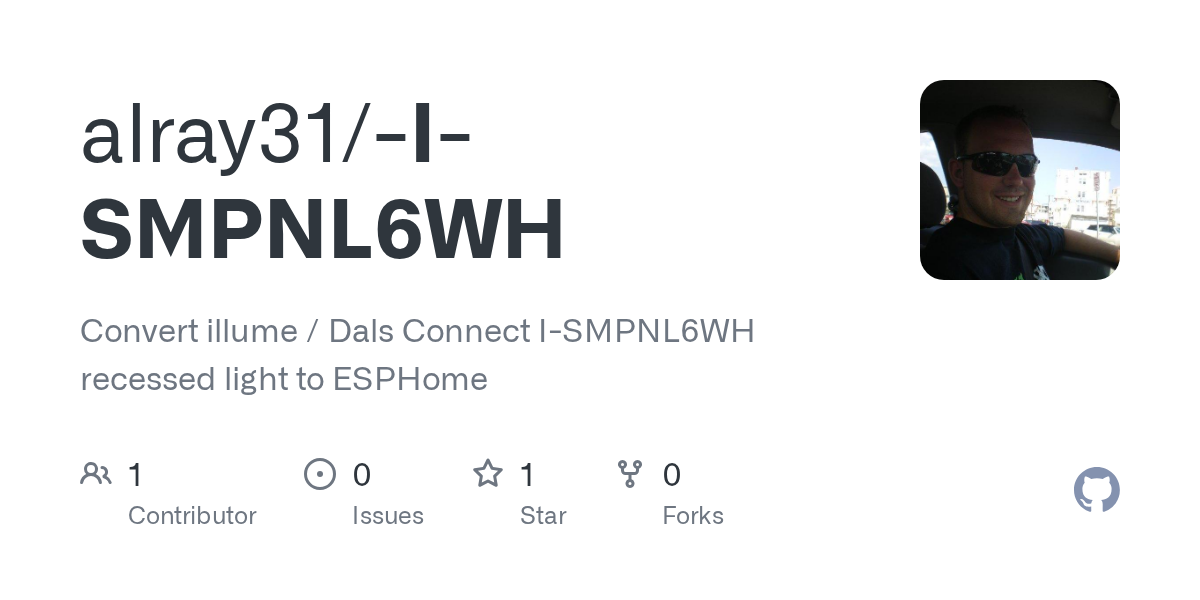

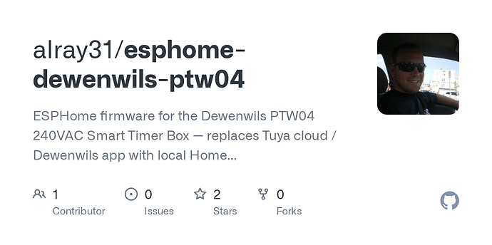

I was tired of this, so I ended up flashing ESPHome onto all the Tuya devices I had (4 lights and a pool timer), which completely wipes the Tuya firmware and frees the device from its dependency on the Tuya cloud. It is a more complex procedure, but well worth it. Once you have done it once, it becomes easier and less time-consuming to repeat for other devices.
That said, it should not be forgotten that the root problem is choosing Tuya devices in the first place if the goal is to have something fully local. That inherently means having to work around the fundamental design of Tuya Wi-Fi devices from the start. Zigbee, Z-Wave, and Matter are protocols designed for local control. Some Wi-Fi devices also support local control, but you will need to check beforehand whether they expose a local API.
If you want to learn more about converting to ESPHome, I have documented the conversion of my lights and my pool timer on GitHub. The procedure for flashing this type of device with Beken or ESP chips is very similar from one device to another but it requires a bit of research.
