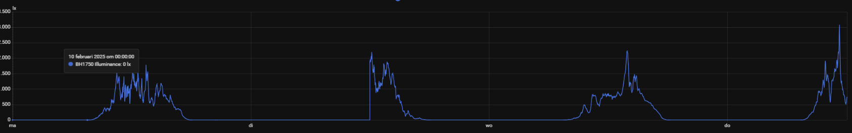

@Blacky i’m missing an option to set a time threshold for the ambient environment. It would be very nice to get the option that the light must be for a defined time under the minimal lux.
I have a couple of lux sensors outdoor and the show nice graphs:
Right now if the sensors reaches the minimal or high value the lights switch directly but i would it to be dark for, lets say, 2 minutes before the lights turn on (or off).
Can this be made possible?

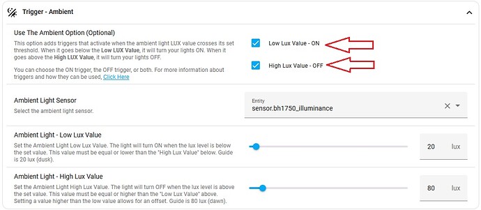

@EvertJob
This is why we have both a Low and a High threshold, to prevent the light from turning ON and OFF too frequently.
The Low threshold turns the light ON, while the High threshold acts as a buffer to keep it ON until brightness rises above it. For example, if your Low is set to 20 lux, the light will turn ON at 20 lux. If your High is set to 80 lux, the light will remain ON until brightness exceeds 80 lux.
Looking at your graphs, the brightness seems to increase and decrease smoothly. Try increasing the buffer (the gap between Low and High) to ensure the light transitions more naturally.
Blacky :grinning:

I’ve built an automation like that myself but after some days i notice that it still “bounce” to much so i edit the automation and add a time threshold for 3 minutes so that when the lux value has reached it’s wait for 3 minutes before executing the script.
My “on” threshold is 20 and the “off” threshold is 240 so there is plenty of room beteen them.

So your asking the same questions on 2 different blueprints.
What one are you using? The YAML you provided is for the sensor light blueprint.
If your going to use this blueprint (Smart Light) then you don’t need your schedule and just use the ambient options and select weekdays if needed.
Blacky :grinning:
Lol. Yup used the wrong blueprint. Changed it and works fine. Now just need to check the lux values…
