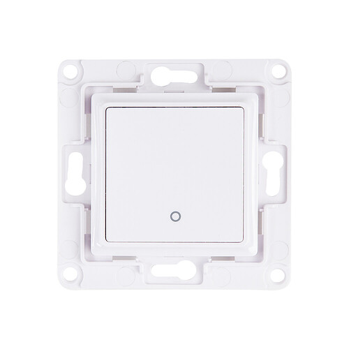

If you replace your normal switch by this Shelly combo it might fit

Looking at the information on the Shelly Website it looks as though the unit is too Deep.
Can you Please explain why you believe that this would fit in a 16mm Back Box?
Thanks in advance
Kevin

You’re right, I misread the figures.

Actually it should fit if you just use it without the ā€œholder adapterā€. Common Shelly device is only 16mm thick.
You need gen4 device though if zigbee is required.
