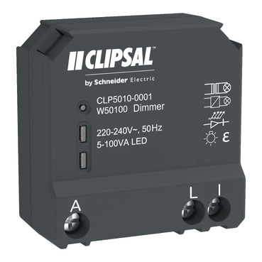

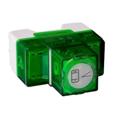

Just don’t use the no neutral puck dimmers. Use the push button mech dimmers that have a neutral. The pucks have flickering issues even with Clipsal’s own downlights.
So use this:
Not this:

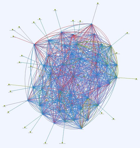

They are routers so every switch in your house will build a very robust mesh.
