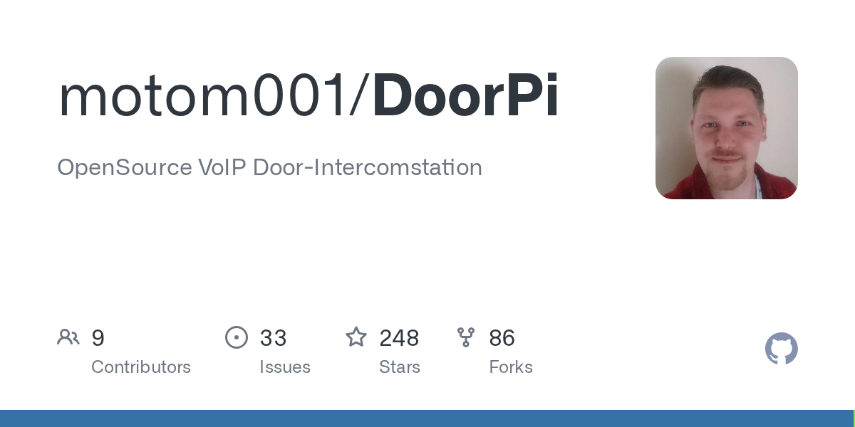

you also said to use DIY, I did, for years I had a door-pi, that was awesome, however that project is so dead, even its domain doorpi.org is gone. in 22 some guy updated the instructions to build it: https://www.youtube.com/watch?v=_9lL_08zQDM, but that’s 4 years old now either.
its still on github
