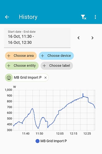

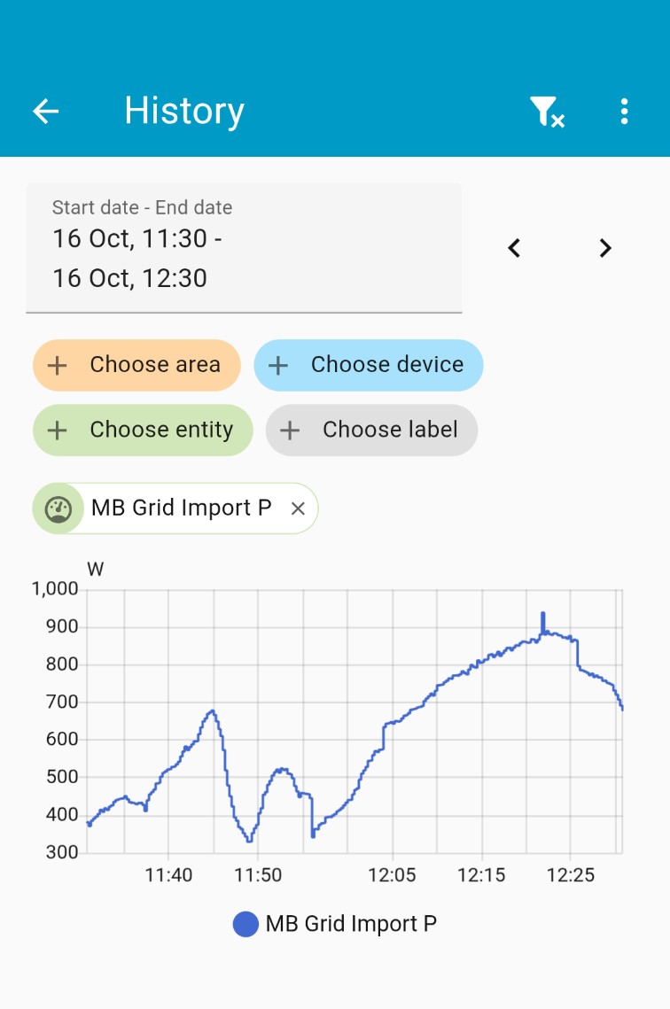

Octopus Energy provide a Mini device, which can be registered to the meter, and then will send live consumption data directly to your Octopus account via the home internet connection. The HA Octopus Energy Integration can, where a Mini is available, pull down real time power and energy figures.
The Mini only needs a USB type power supply point, and to be in range of the smart meter. I find the HA Integration updates every 2 or 3 minutes, which is near real time, and compares well enough with my solar inverter which reports, from a CT clamp meter, every 15 seconds via my own Modbus polling.
