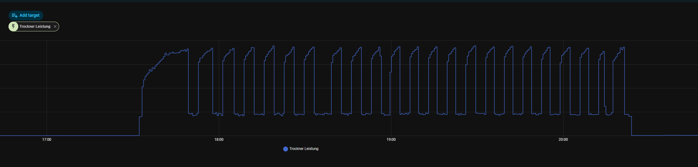

Hi, I’m trying to make my tumble dryer smart. I have a smart plug and I want to create an automation that notifies me when the dryer is finished.
So I created this automation:
description: ""
triggers:
  - trigger: numeric_state
    entity_id:
      - sensor.trockner_leistung
    for:
      hours: 0
      minutes: 1
      seconds: 0
    below: 30
conditions: []
actions:
  - action: notify.mobile_app_pixel_10_pro
    metadata: {}
      message: Der Trocker ist wahrscheinlich fertig.
      title: Trockner ist fertig!
        channel: Appliances
mode: single
Now I want to add a condition, that the value has to be over a certain amount bevor. Something like: If the “Leistung” is below 30 for 1 Minute after it was above 30. Otherwise I also get notified if its turned on or in standby.
I have no idea how to add this second condition since I’m new to home assistant.
I highly recommend using this blueprint by Blacky, it serves quite well for this kind of thing.
Thx, this Blueprint works perfectly.
