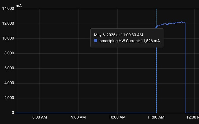

I am in 240V land and use 16/20Amp smart plug (Yes-chinese) so well rated within the demand of 12Amp…
though limited to the sample rate of the meter so not really expecting to see the inrush current from the cold heater, and resistance heaters that are installed don’t normally exhibit very high inrush… (I have not tested with an oscilliscope as mine is in store overseas, so can’t verify for my actual heater)
Anyway, once starting to try and control the boiler to optimise solar consumption (under load switching off, as opposed to prior I was just disabling ‘on’ when no daylight) the plug failed as per OP’s same symptoms. (Still switches but not once there is any load.)
