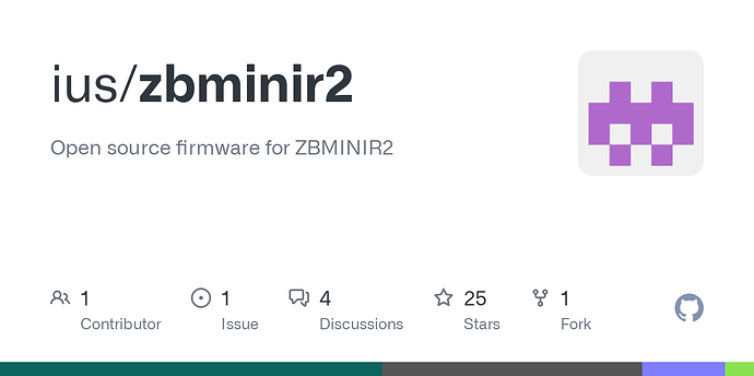

You can try custom firmware for the ZBMINIR2. It supports binding, but it requires a debugger and soldering for installing:

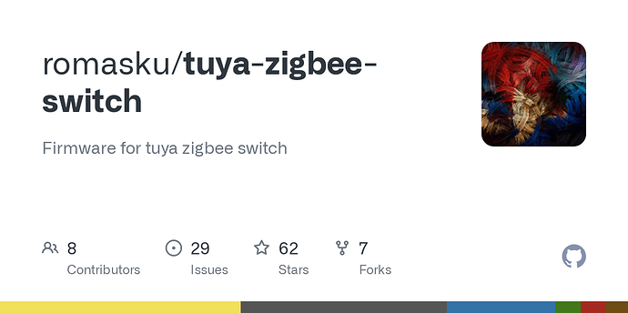

If you’re interested there’s also custom firmware for Tuya Zigbee switches that supports binding. This can be flashed OTA:
