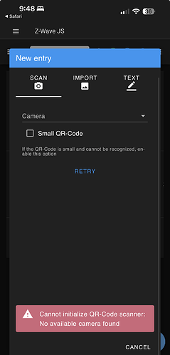

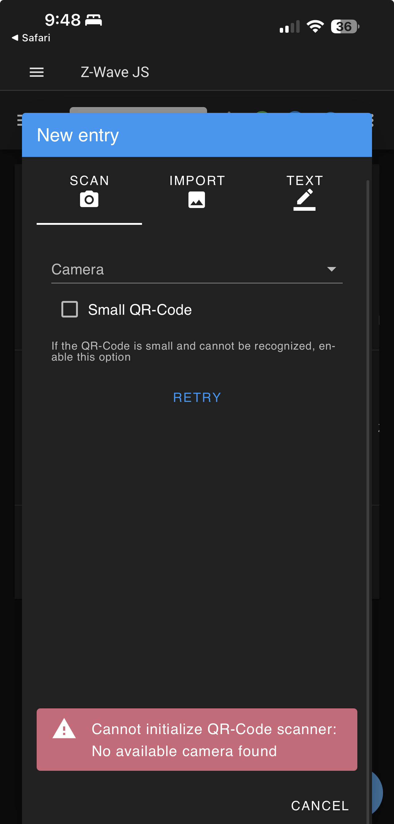

Smart Start iPhone Camera Error
I tried to use my iphone camera with smart start and I get this error. Can this be fixed?
You need to access Z-Wave JS UI via an https URL to use the camera from a browser.
Otherwise, the HA Companion App works when scanning in HA at least.
