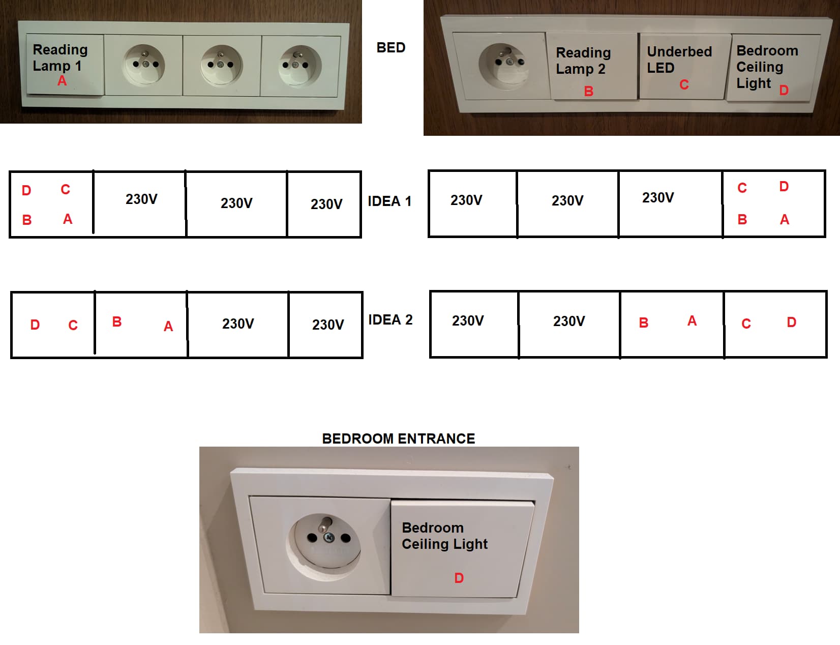

I am new to smart home integrations. Below you can see my bedroom switches and what I would like to add. Light switches don’t have neutral (but 230V has - can I use it?)
I need your recommendation for switches which will allow me to create symmetrical controls of what is now. It will probably need to add virtual switches to Home Assistant. I will need switches which will use frames to integrate 230V sockets together. If possible I would also be able to turn off the light in wardrobe - didn’t show it in scheme of switches as it is not connected together anyhow to switches next to the bed. I am located in EU. If it is possible I would love to use Aqara, Moes or Sonoff first of all.

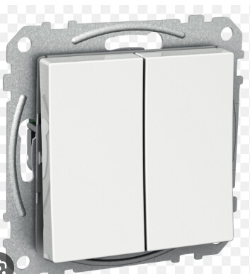

It would make more sense to replace the single switches with dual switches of the same serie and use smart relays (like sonoff mini duo) to make them smart.
If your outlets and lights come from different circuit brakers, it would be correct installation to bring neutral from “light-line”. Mixing neutral and line from two circuits is likely not allowed by code in your contry.

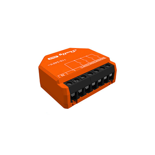

If you want to keep the physical switches as is then you are looking at installing at least a relay like this for a 4 way switch setup:
For single gangs you can install this one just to stick with the same shelly eco:
