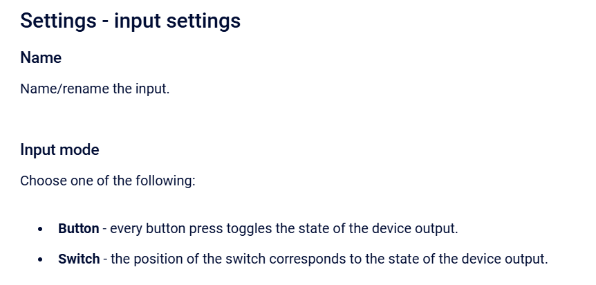

I don’t have any to try, but it’s strange I can’t find any confirmation for that. Shelly i4 documentation gives:
@Karosm @christopher.g.reed
Shelly i4 100% can work with regular switches or momentary buttons. You lose many functions when they are set to ‘switch’ mode vs ‘button’ mode
